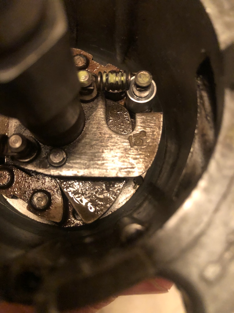

Rocky_LC
Here’s how I did it…. Made a spacer, 3/16” ID, .320” OD.
This limits my mechanical advance to about half of the stock capability of 13*, which is what I’m looking for.
Rocky
