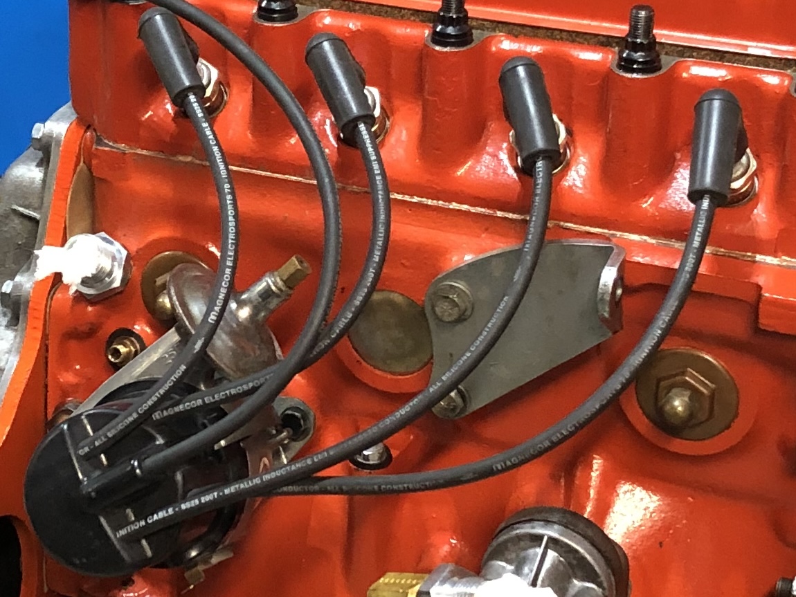

Worth rechecking the firing order as well If you had the wires off.
RickF
Platinum
Just flip the wires around at the plugs. Exchange 1&3, 2&4. That puts it 180° from where it is now.
