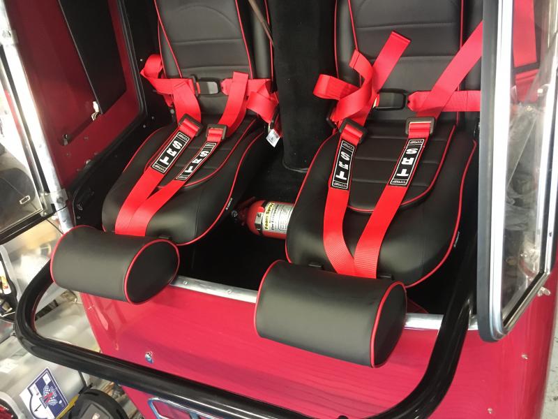

Just fitting a pair of Corbeau sportsman recliner seats to my frogeye, They look really smart trimmed in the cars colour. They needed to be bolted directly to the floor pan and I have managed to make brackets to line up with the existing two centre fixing holes which are in the channel and the two outer fixings run through the box section so it makes a secure fixing. The seats are a little narrow but they fit well with my roll bar and have a bonus of headrests that can be removed so the tonneau fits. There is no for and aft movement as they are secured as far back as the rear bulkhead will allow but ok for me at just under six foot. The recliner allows the seats to be tilted for rear access. Will fit a three point harness as the rear webbing will go between the top of the seat and the headrest. Pics to follow when finished.
4tecdog
A good Sunday’s work fitting the seats and harnesses. 42A49291-E74A-45F7-B50C-37308EE770DB.jpg6DDACAF9-7C41-4442-BCAA-829068C0CC5F.jpg1C3C1339-4989-4702-977C-A12AD988CD8D.jpg

Could you add a photo of the total car c/w seats and headrests? Just curious how it all looks. Thanks, Doug
T
twas_brillig
Also, which model TRS seatbelts are you using and how convenient do you and your passengers find them? I've got old racing harnesses (sans the crotch strap) in our Meyers Manx Clone dune buggy and noticed that my 42 year old daughter only did up the lap belt when she was using it a bit ago, rather than clip all 4 straps together. Thanks, Doug
