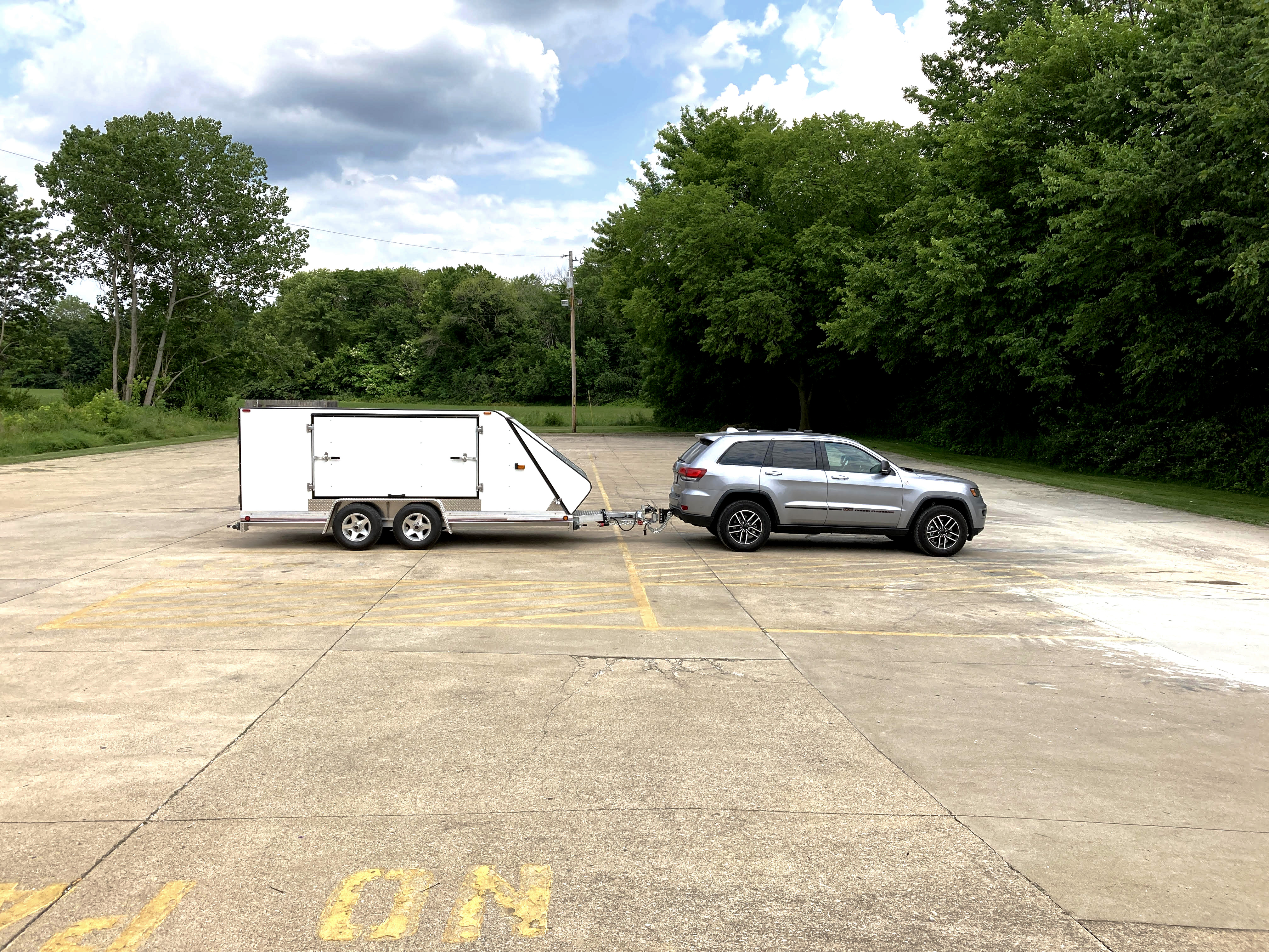

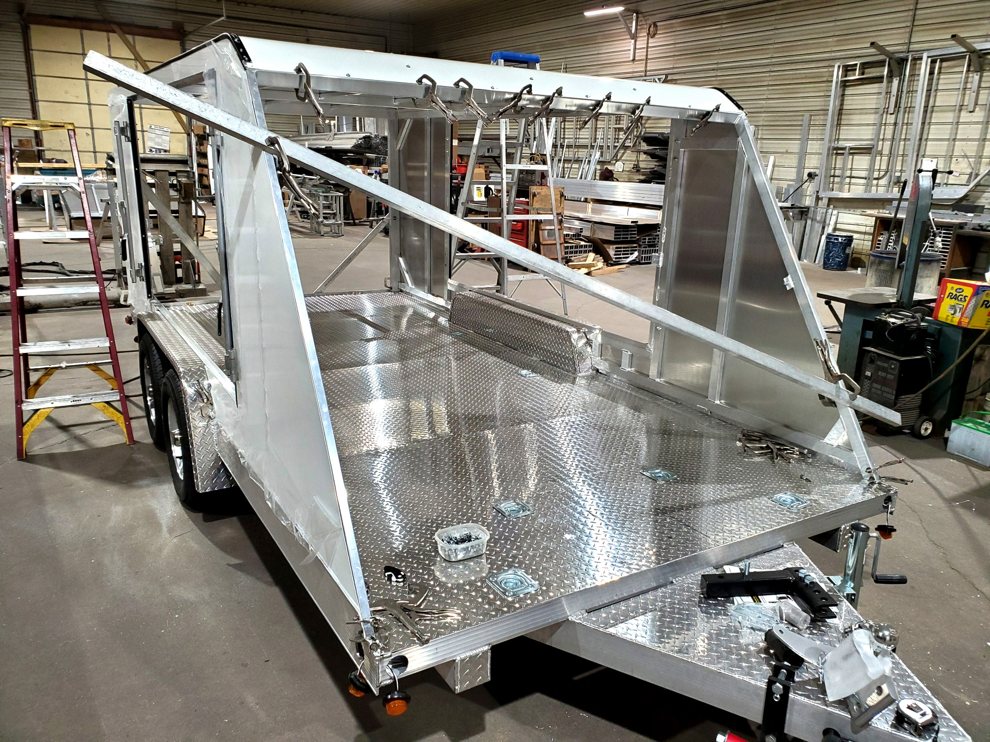

Hi LAW75,

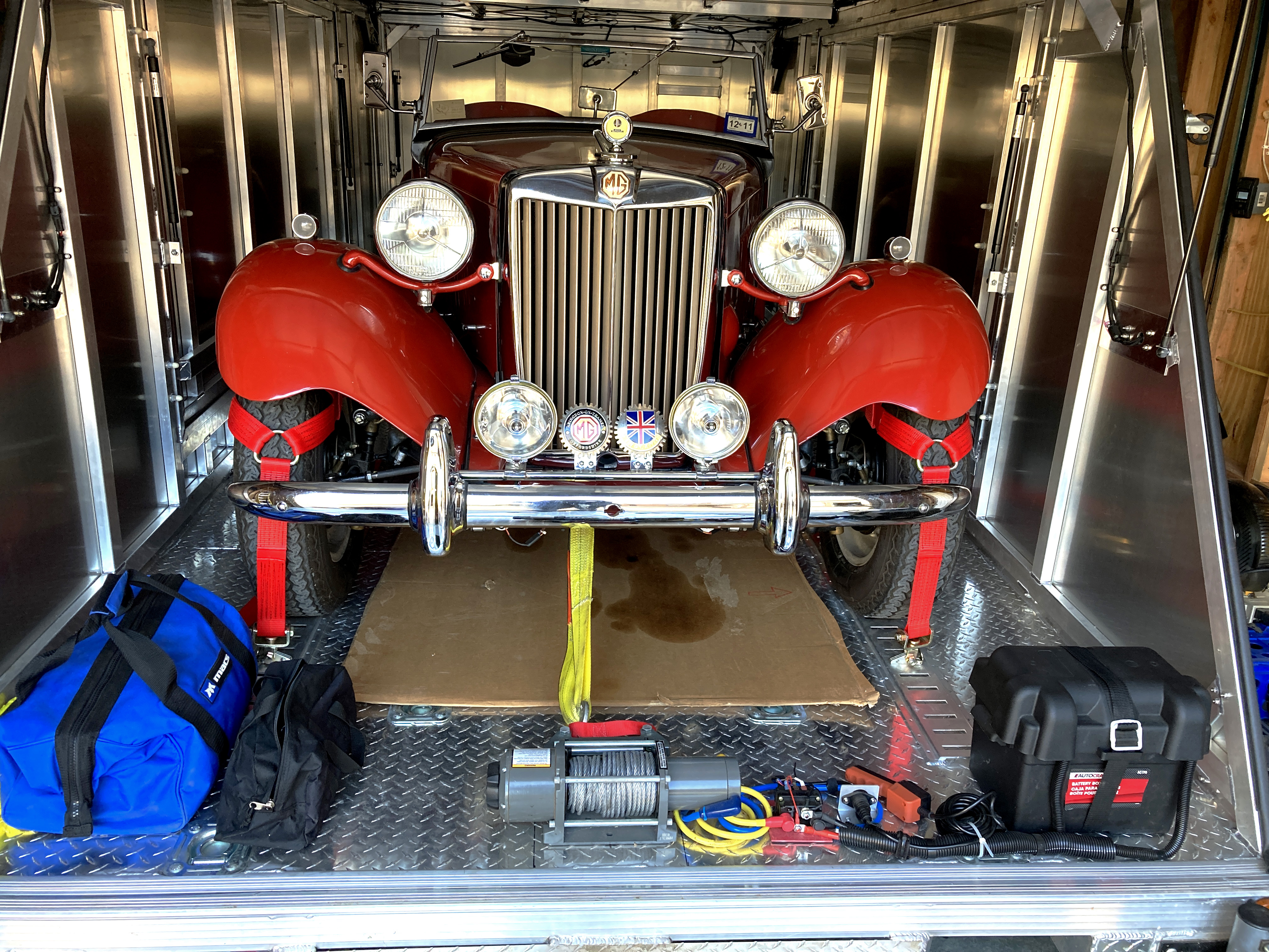

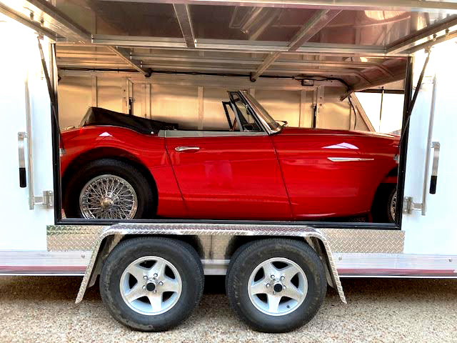

I had a trailer built 3 years ago to my specifications. Most people buy a fairly large trailer. However, we wanted a compact enclosed trailer that would hold any of the 1950 to 1980 small British cars. We also wanted good access to the car to move around the car as needed to load, tie down and unload the car.
I designed the trailer around chassis blueprints of our MGTD and 1967 BJ8 cars (the length was increased 1 foot over that shown in the first picture). As you can see from the pictures, the trailer has four doors that provide complete access to the car and loading winch. And, as Michael said, we use wheel nets fastened to tracks to hold the car down so it is free to move on its own suspension. The last picture shows a compact trailer mover that helps move the trailer in our driveway and store it in one of our garages. You can literally spin the trailer 360 degrees in a 22 foot space.
A major consideration for us was having no more trailer than needed to make it easy to tow and easy to store in a standard garage bay. This also made it perfect for moving through gas stations and finding motels with adequate parking during trips. Sometimes, less really is better!
We towed our BJ8 2500 miles through steep hills at 80+ miles per hour behind a Grand Cherokee Jeep (Hemi engine). The trailer tracked and braked perfectly; and was mostly forgotten about during the trip.
Regards, Bill
EDIT:
Looking at the picture, you can see we load and unload the car with a winch. And, I would NEVER go back to a drive-on trailer again.
Also, the bottoms of the two side doors on the trailer are low enough to allow the car doors to be fully opened for easy access as needed/wanted.

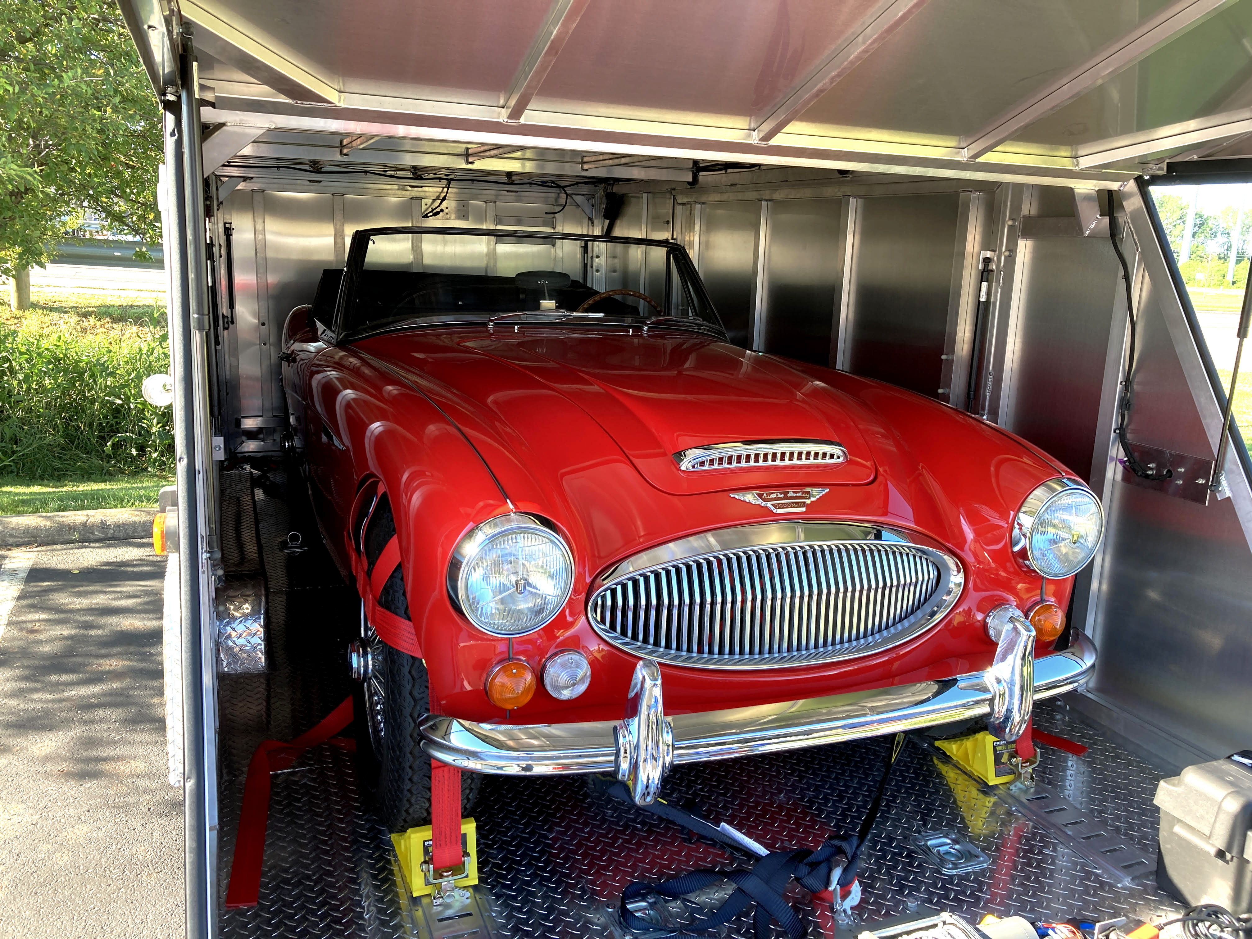

Several additional pictures:

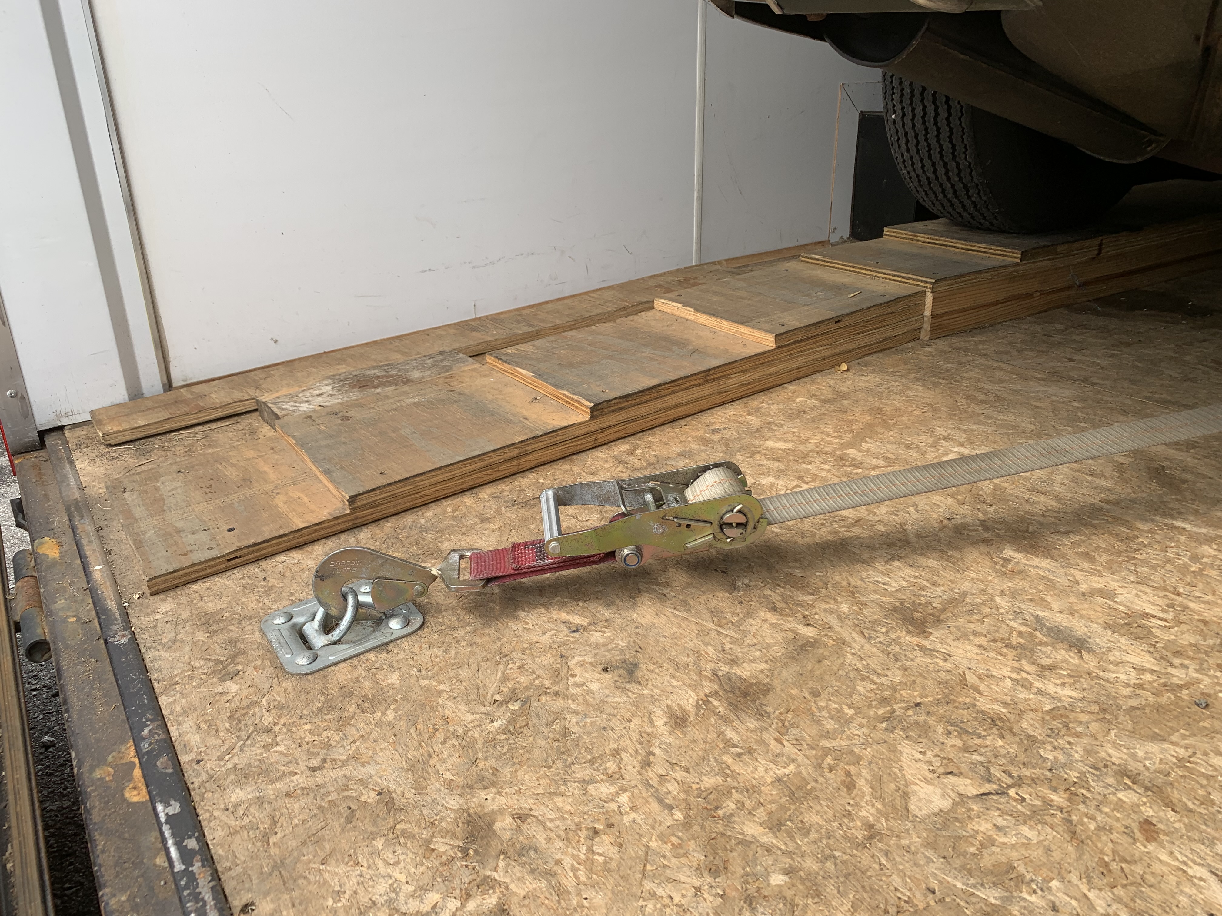

For Corvettes (my other hobby) we put 2x10 or 2x12s screwed into the floor to raise the car. Often 3 on the driver's side, 2 on the passenger's. Bevel the entry end of each board to allow easier movement of the car. This then lifts the car off the floor of the trailer, tips the driver's side up to incline the door away from the hump, and also makes it a lot easier to get under the car and attach any straps.

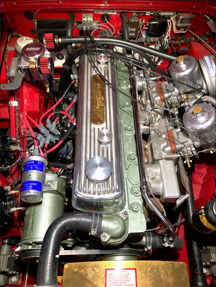

Bill. Your car looks so fine, especially as a "driver" and even if you were to show. Did you install and ac? I assume that is what is on the right side (as sitting in car) near the firewall? Thanks for sharing.

No, no AC. You probably see part of the breather system. I am playing with it now and will eventually connect it to the exhaust.

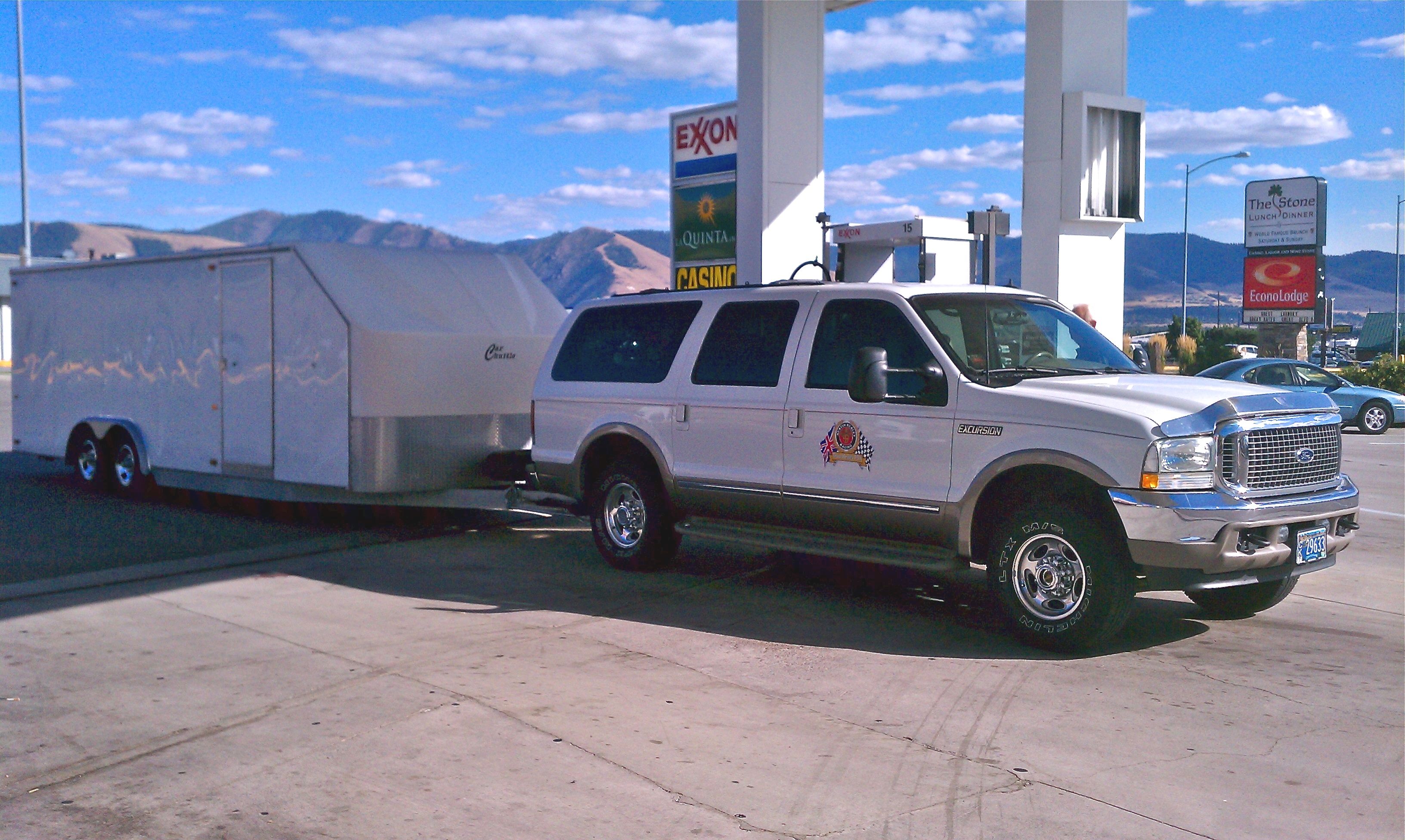

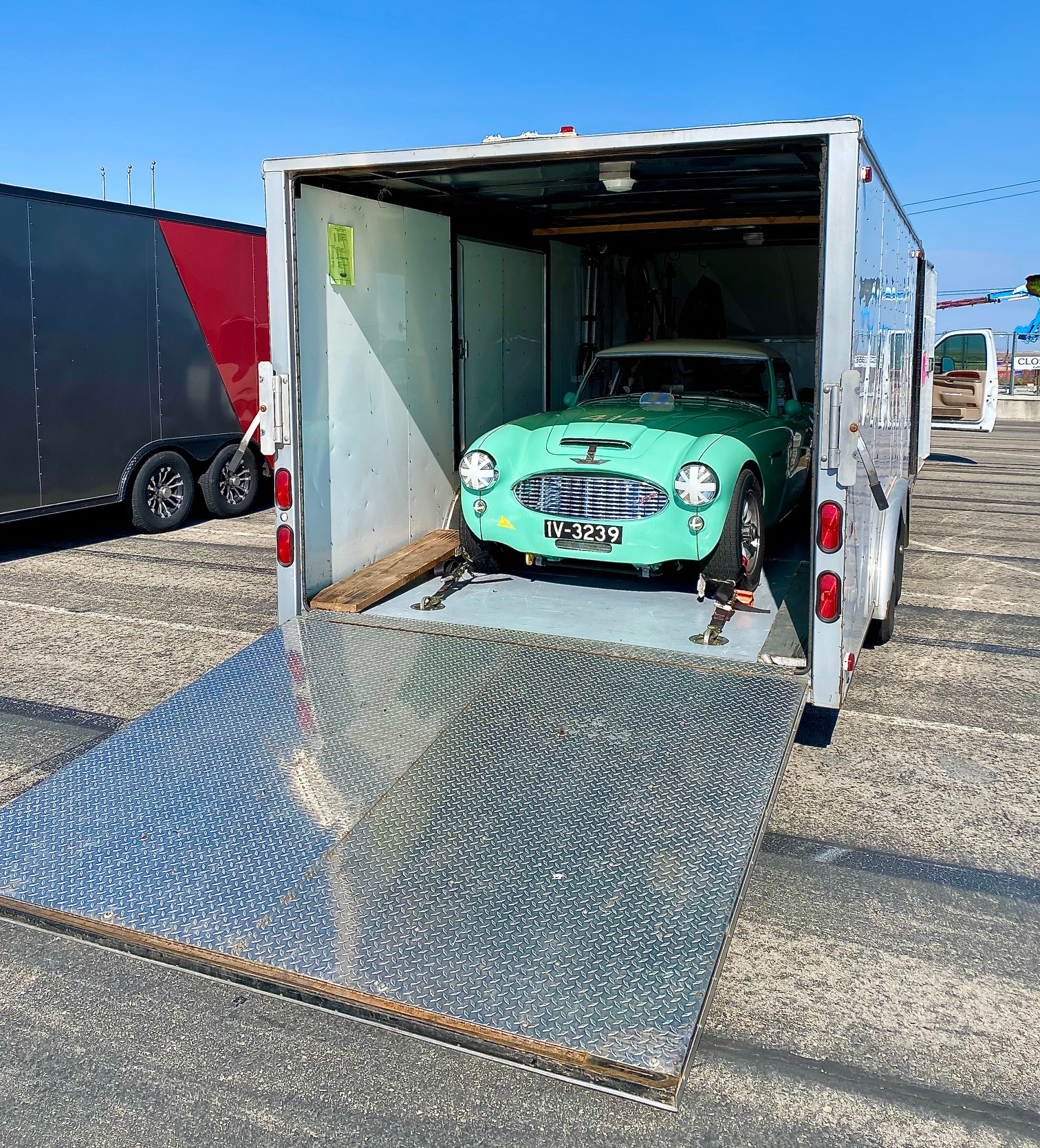

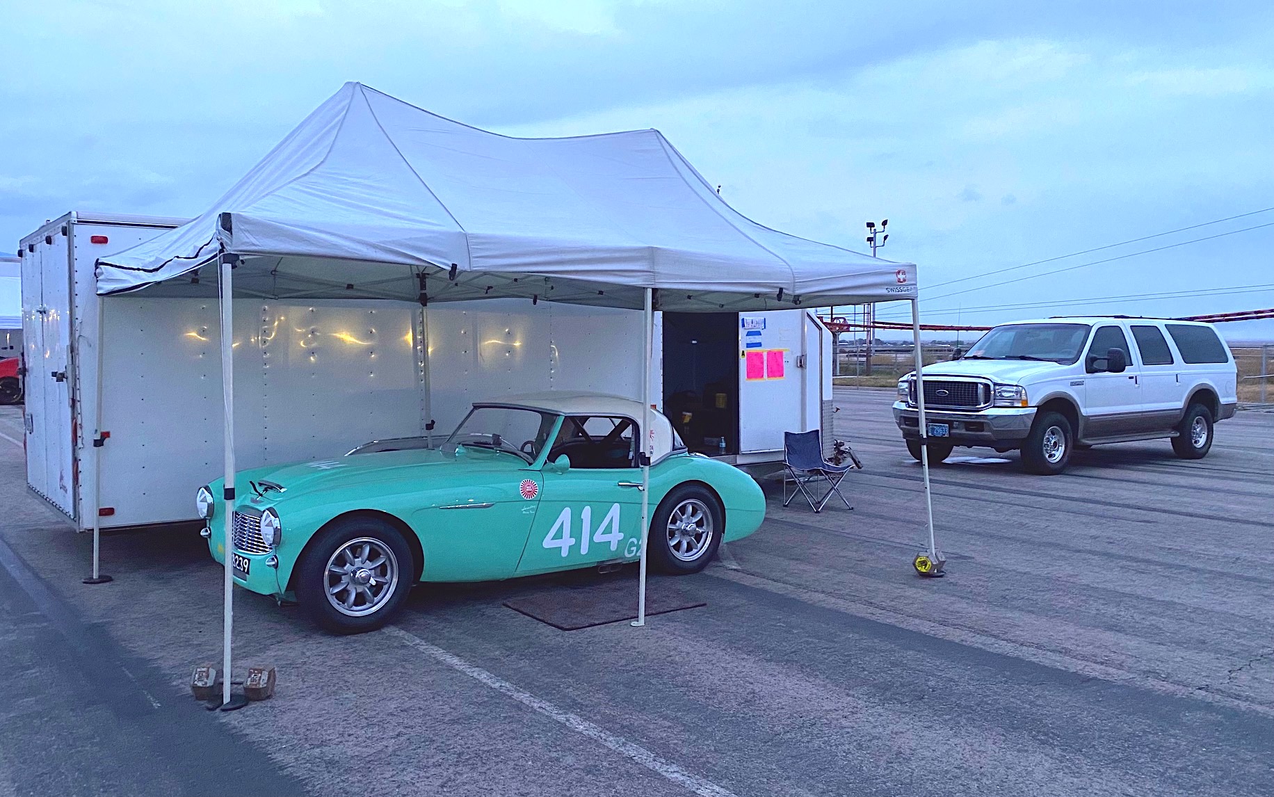

I've haul #414, my '57 vintage racer across the USA multiple times with a 23' Car Shuttle trailer. Large enough for the car and all the race spares needed for a competitive race event.
