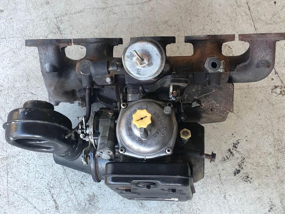

I just bought a '66 that's incomplete. I'm no stranger to MGs, so I know my way around the naughty bits of an SU, but I'm more of a tree-hugger now, so I'd like to have a car that doesn't pollute quite as much as my other 3 MGs did. I'm also trying to save some money on this build.
Going rate for a pair of SU HS4s with linkages is around $350. I've found a few downdraft Webers in the $300 range. I'm not ready to go Megasquirt, since it involves too much scrounging and fabrication. And I just stumbled across a complete '77 single Zenith with the exhaust manifold and a cat installed for $120. Probably because they're what everyone else is getting rid of when they install Webers. I don't need a really fast car, and my recollection is that even my fastest MG still wasn't a fast car, so I'm wondering if these might be a good option for me.
Is this something I can put on a stock '66 engine?
Does it need a smog pump and the associated air fittings?
Will the performance be terrible?
Would I lose a lot of resale value by going with something non-original?
Are there other more modern carbs (or even FI throttle bodies) that can be installed on this manifold?
Would it actually help with the emissions?

Your '66 was engineered to run with the dual SU's; can't go wrong with sticking with them.

I would stick with the SU's. I understand the environmental aspect of it but, the ZS was designed to run with all the other smog stuff - air pump/ evap canister/ air rail etc. etc. On my Midget it was genuinely unhappy without them (they were off the car when I bought it). I think a properly setup set of SU's will be about as clean as any engine of that vintage can expect to be. And don't forget that the fact of owning a 1966 car and still using it MASSIVELY offsets the carbon footprint of building a new car.
In terms of a cat - I run a Harley Muffler on my Midget - it has a catalytic converter built in (or so I am assured) - I got mine cheap from a harley dealer as it was a take off.
If you are that concerned about emissions, you could maybe swap in a Miata engine for the joy of an MGB with the efficiency and environmental compliance of a modern car.

There are many problems with what you want to accomplish. If the car is on the original motor, the head will not have ports for the air rail to start of with.
There are many issues with the factory set up of the cat and manifold.
Fit a side draft Weber and go.

Hi Vardaman, JohnGone here. I could use that set up. Have you scoped it out? I understand cracks in the manifold are the key problem. You can pm me at (jcremer(at)gmail.com)

It's in Oregon, so I haven't been able to look at it. I'm in Washington.
I'll send you the link, since it doesn't sound as though it will work on mine.

The "sweet spot" of MGB production was '66~'67, IMHO. 5-main engines, no degradation of the power output ( a whopping(!) 99HP). Putting that engine into original running spec's at this point would have about the same effect on the environment as would dropping another grain of sand on Hermosa Beach. A pair of SU's would be less problematic than all other options, in that it was how the thing was designed as a unit. As Grantura suggests, a side-draft 40mm Weber would be next-best option. All downdraft conversions have setup issues, some without solution. The Zed-S induction & emissions stuff was a concoction thrown together by Leyland as afterthought, so as to continue selling cars to the US market, and an abomination for those of us who worked in service shops to keep them compliant.
And one more '66 MGB running original induction has less deleterious effect on the planet than the army of Z3's running around now, anyway.

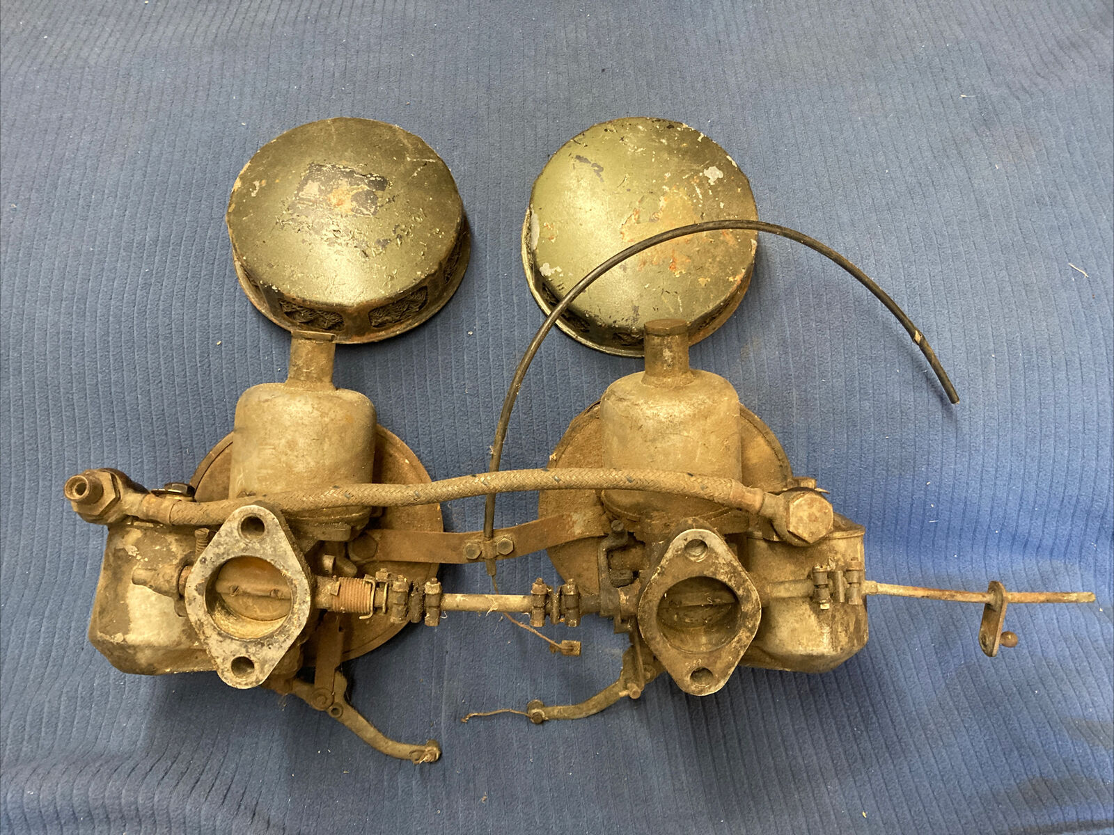

And it's a miss!! Didn't notice the mounting flanges on the used pair that I bought, which are not at the proper MGB angle, but are straight up and down (pictured below). Probably from an MGA. Still worth $100. And I've found that my FIL who has owned lots of British cars has a pair of HIFs that he'll send to me.
