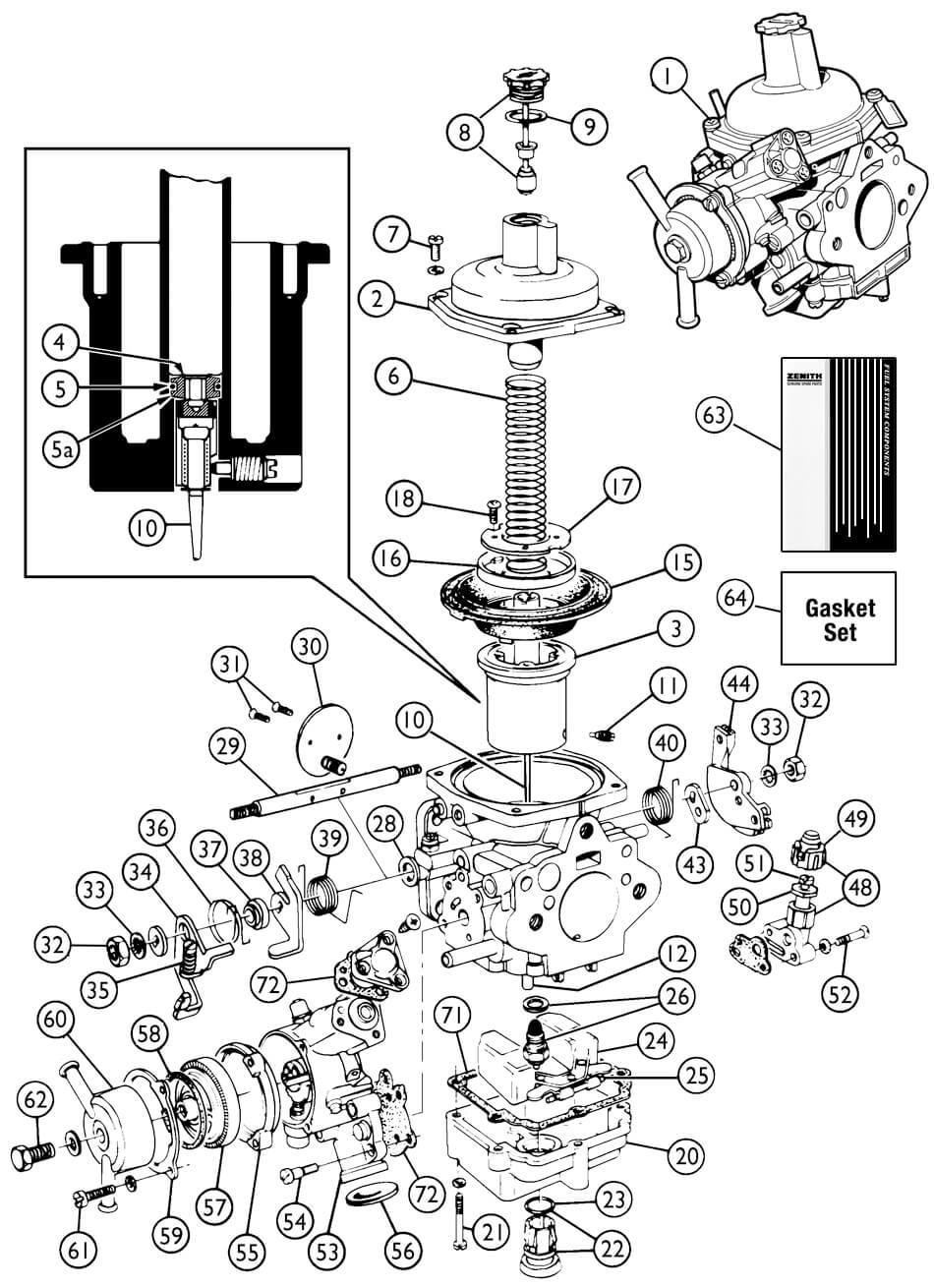

I have a 175CD carb on my 1980 mgb. I calibrated the thermo element and I need a new gasket that bolts the housing to the heating element. Does anyone know the PN for this gasket or where I can get one? Now I am waiting for this before getting it back on the road again. Thank you

Moss Motors under MGB - mossmotors.com/mgb/fuel-intake-emissions/zenith-stromberg-carburetor

Haven't seen one in years now, but seem to remember it's just an o-ring. Try a bearing supply house locally, they usually deal in seals and such as well as bearings.
