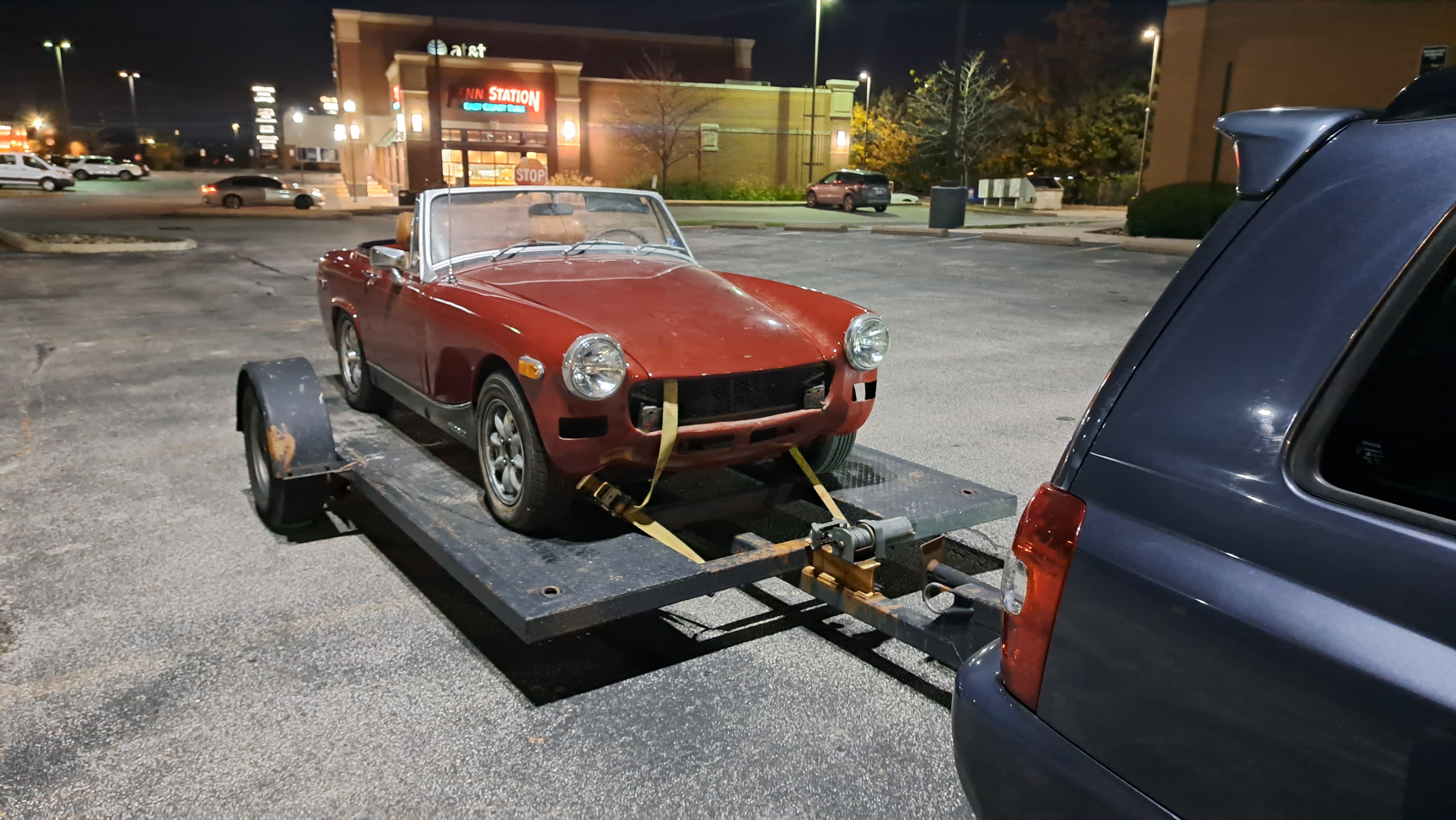

Hello all, I haven't properly introduced yet, however, I've adopted a 75 Midget 1500 with a Zenith carb and stock air box and can't find an air filter element, Moss is back ordered and most places I've looked don't even list it. There is a dirty NAPA 2151 in there now, but NAPA's site doesn't recognize the part number. Is this just a Unicorn now? Made of Unobtanium?
Thank you in advance. I plan to post up a thread or something in a bit on the car. Doing the chrome bumper thing to it and otherwise just going through the revival from prior owners storage - fuel flush, brakes, etc.

Here's a quick pic

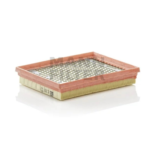

I think a MANN C2151 will fit.

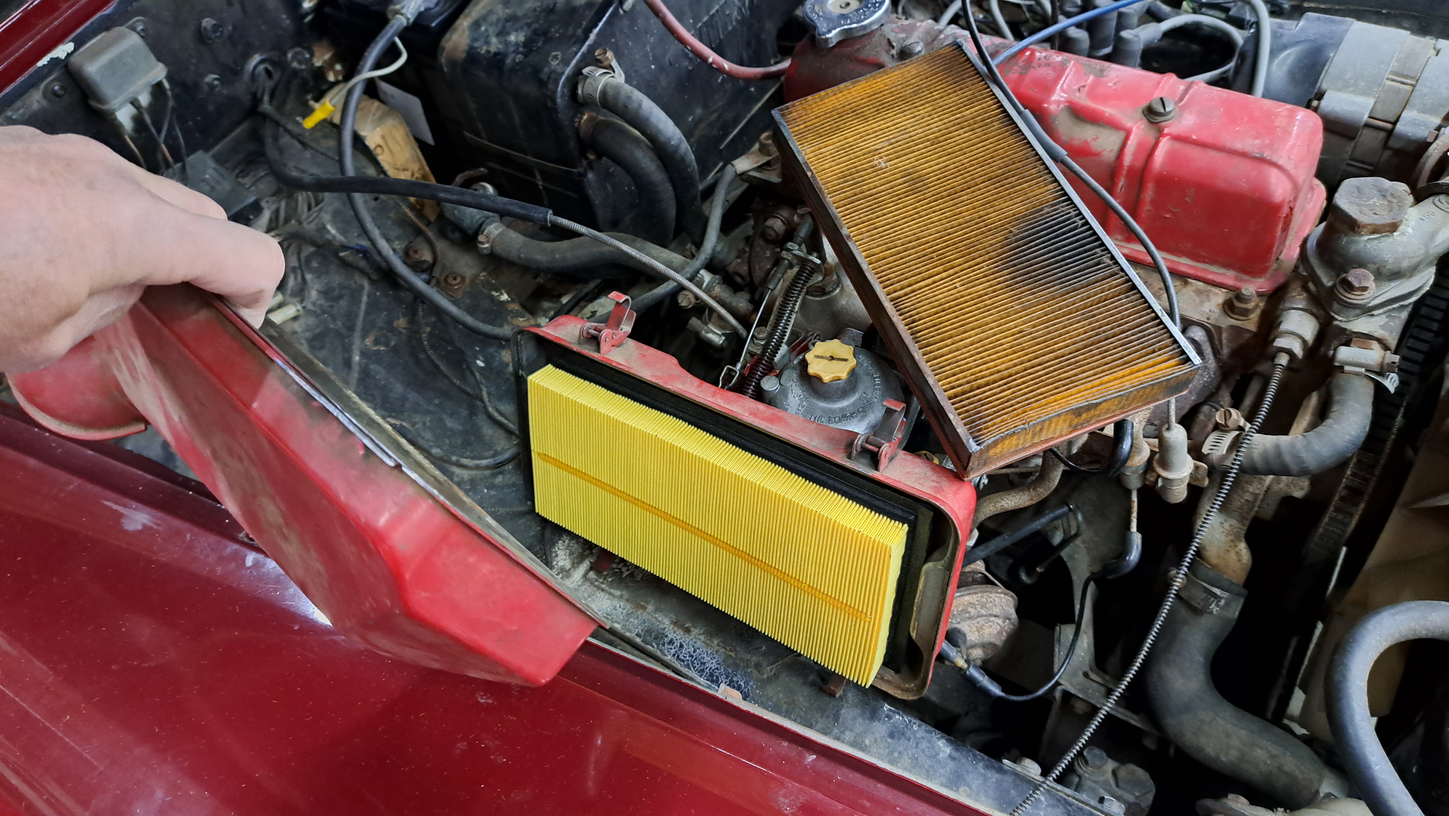

I got my air filter from thewedgeshopstore.com link and it fits. Picture attached. Thank you everybody!
