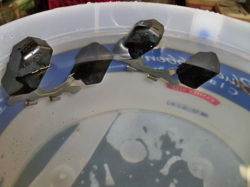

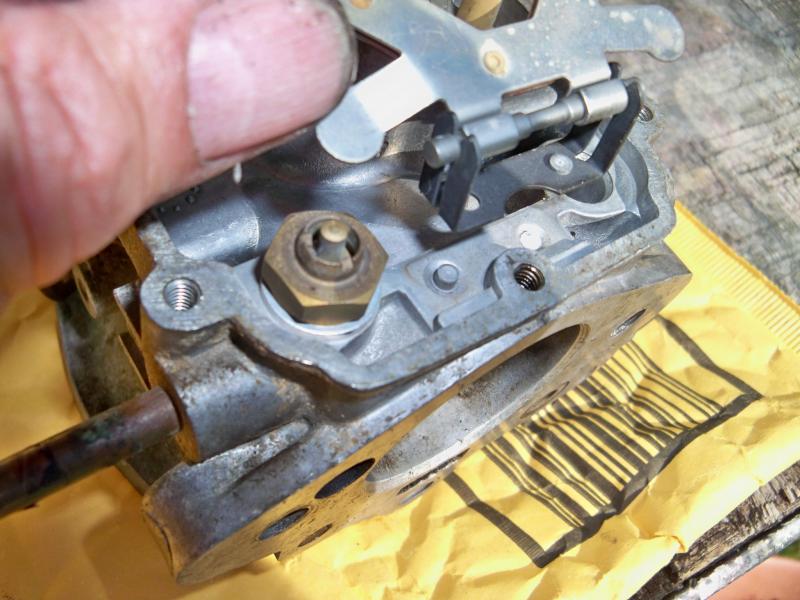

poolboy
I don't know about the "1/2 way up" part, but at 17 mm the floats should put enough pressure on the needle valve to shut off the fuel when the proper level is reached.
You could check the floats for bouyancy and have a look at the float pivot bracket...but to have both carbs over flowing would be unusual in those scenario.

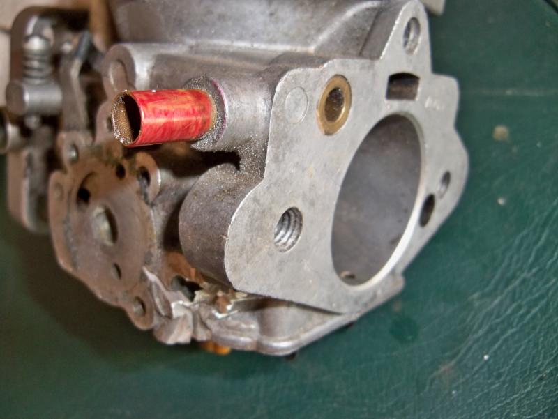

If all that checks out...fuel pressure, float bouyancy, float height, float brackets, proper gasket installation, needle valves working.... then the only other thing I can think of is excessive air pressure within the float chamber...What
do you have connected to the float chamber vent nipples ...the 'red' ones ?
poolboy
Since it's simple to do, unplug that hose from the Carbon Canister and see if the leak stops....I don't see why it would matter but just try it.
