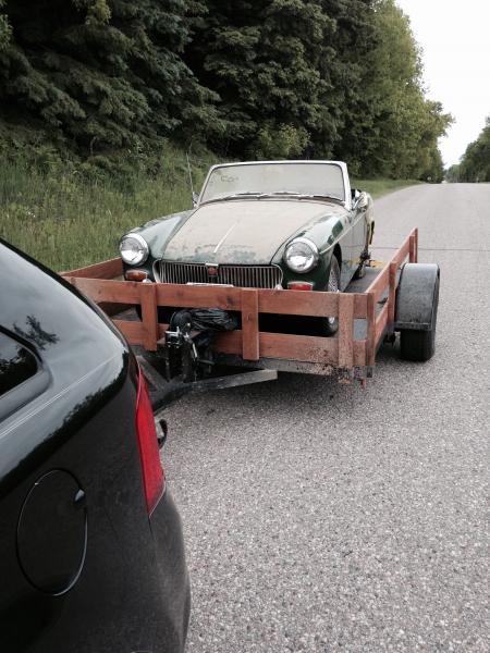

I just picked up a late 60s Midget parts car with a 6x12 U-Haul trailer (2" ball) with ramp and hauled it about 250 km/150 miles. I wrapped a chain around the rear axle and tied to the rear corner d-rings then wrapped a short piece of chain around the front crossmember (no engine nor radiator nor grill nor hood) and used a come along through the grille opening tied over the front edge of the trailer down to the hitch assembly. The trailer has hydraulic brakes (driven off the loading of the hitch when you stop) and a maximum speed limit assigned at 88 km/hr (55 mph).
I'll be going back to pick up another onewith wire wheels tomorrow but there's a bit more body that will be in the way on that one.
If I was hauling a 'real' car, I might have throw some 2x?? down on the floor between the tyres and the sides of the trailer. And the box is 6 ft wide, but the entranceway is 57" wide (as mentioned earlier), so adequate room if you're careful. Doug

More learnings: picked up the wire wheel 1970 Midget today, and the knock-ons stick out further than yesterday's 1969 midget parts car was wide. A PO had heavily modified the front, but there was no front bumper but still only maybe 1 or 2 inches maximum from end to end on the trailer - so make sure you measure your over all length as I'd just pulled up something from the Internet, and it was wrong. Used the same technigue as yesterday, with a chain around the rear axle and the come-along tieing the front D ring back to the axle as I couldn't get to the front crossmember etc. I checked maybe half way home, and the come-along had gone slack. Remember I'm just hauling pars cars, but doubling up everything when hauling vehicles of value would be A Very Good Thing. Doug
twas_brillig
Dang! Unloaded today, and learned that the reason I had no free length available to secure yesterday's parts car was because a previous owner had lengthed the vehicle about 8 inches as part of installing a Ford 2.8 litre V6/automatic. Livin' and Learnin'. Doug
