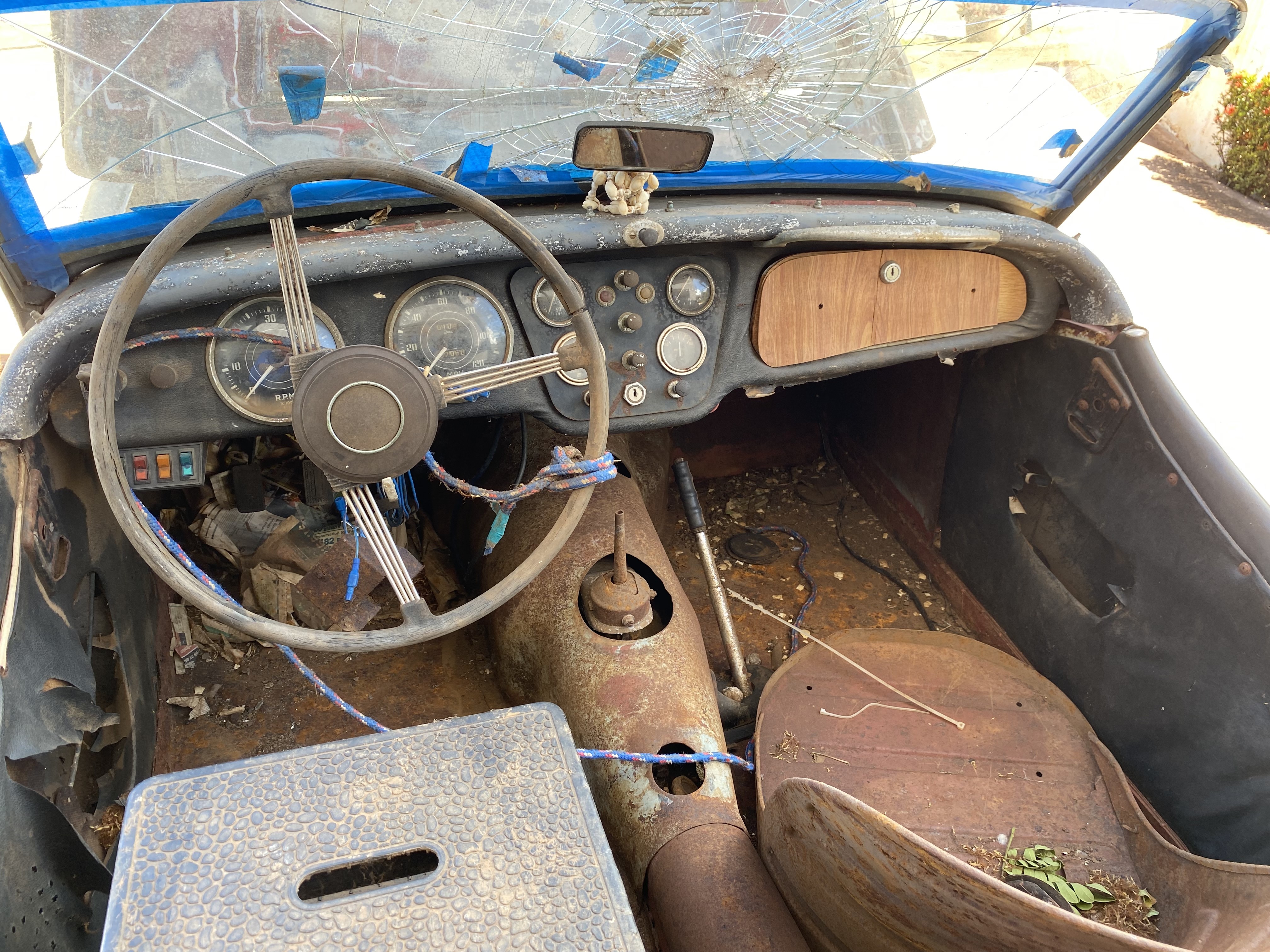

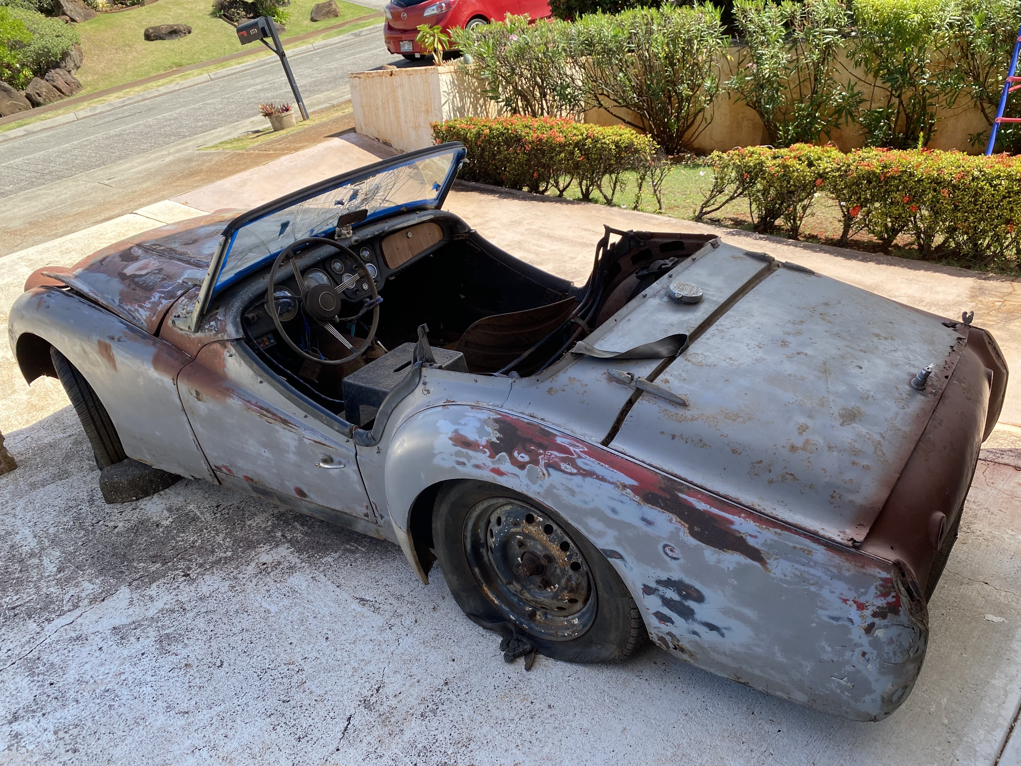

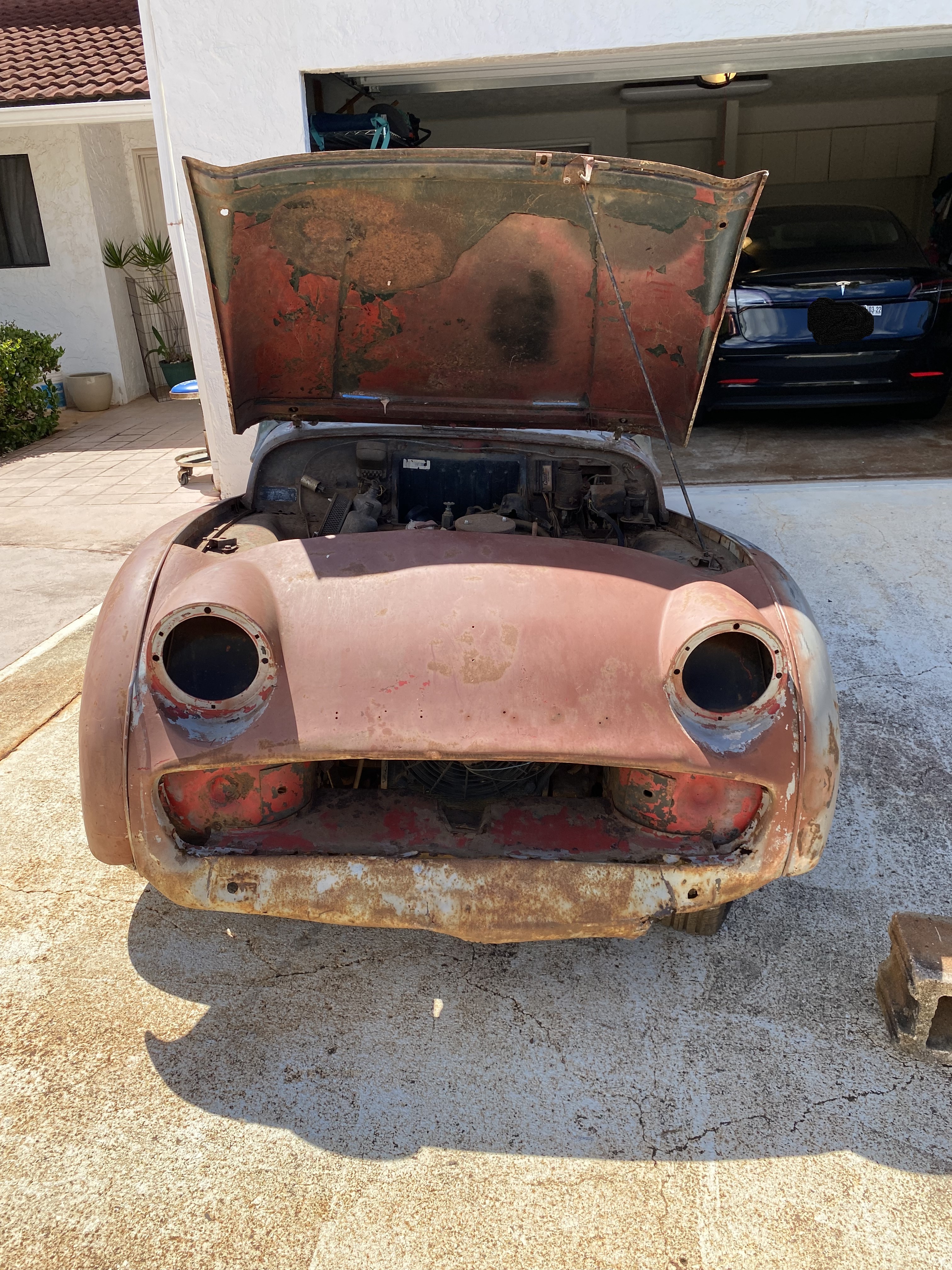

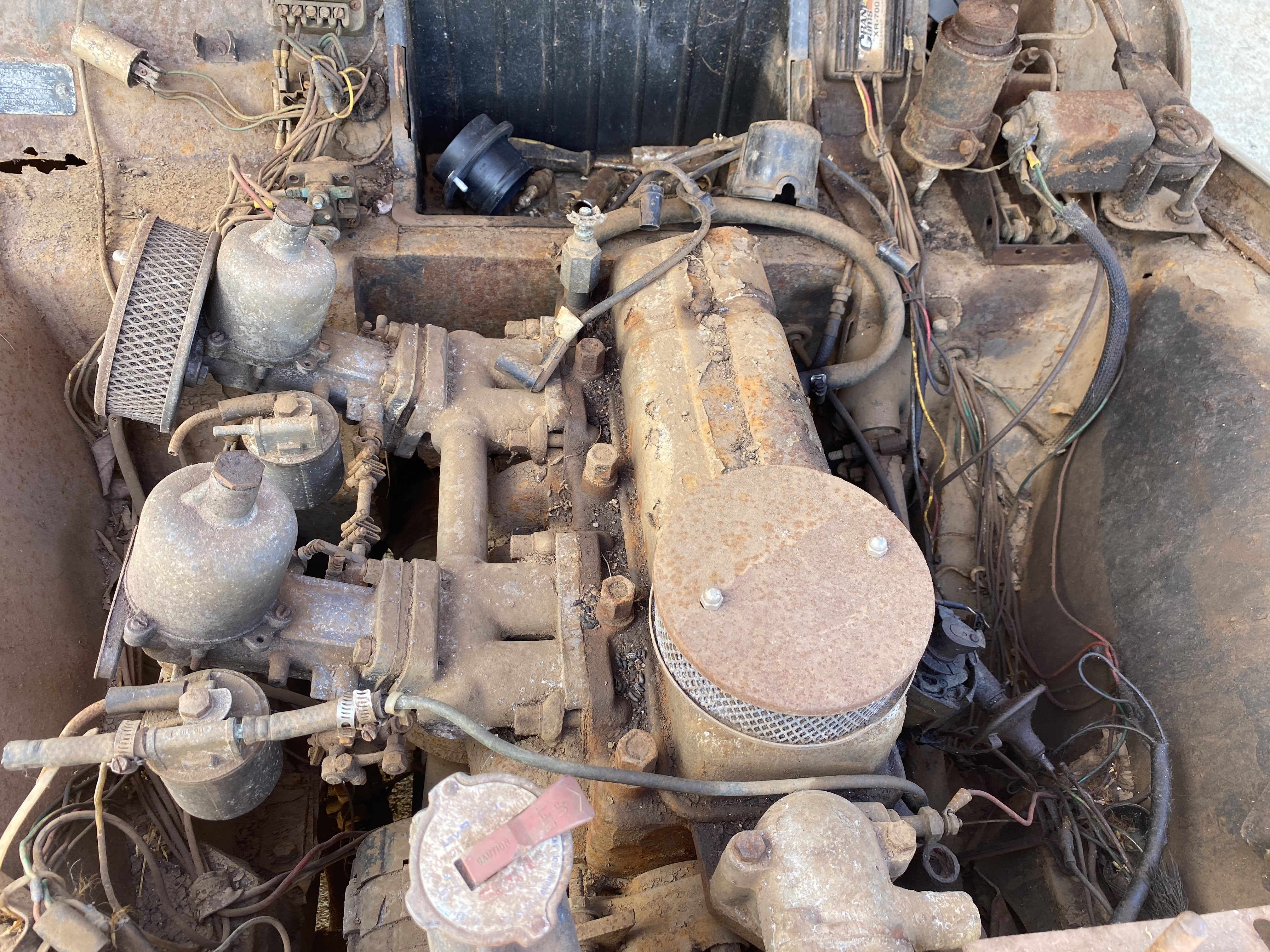

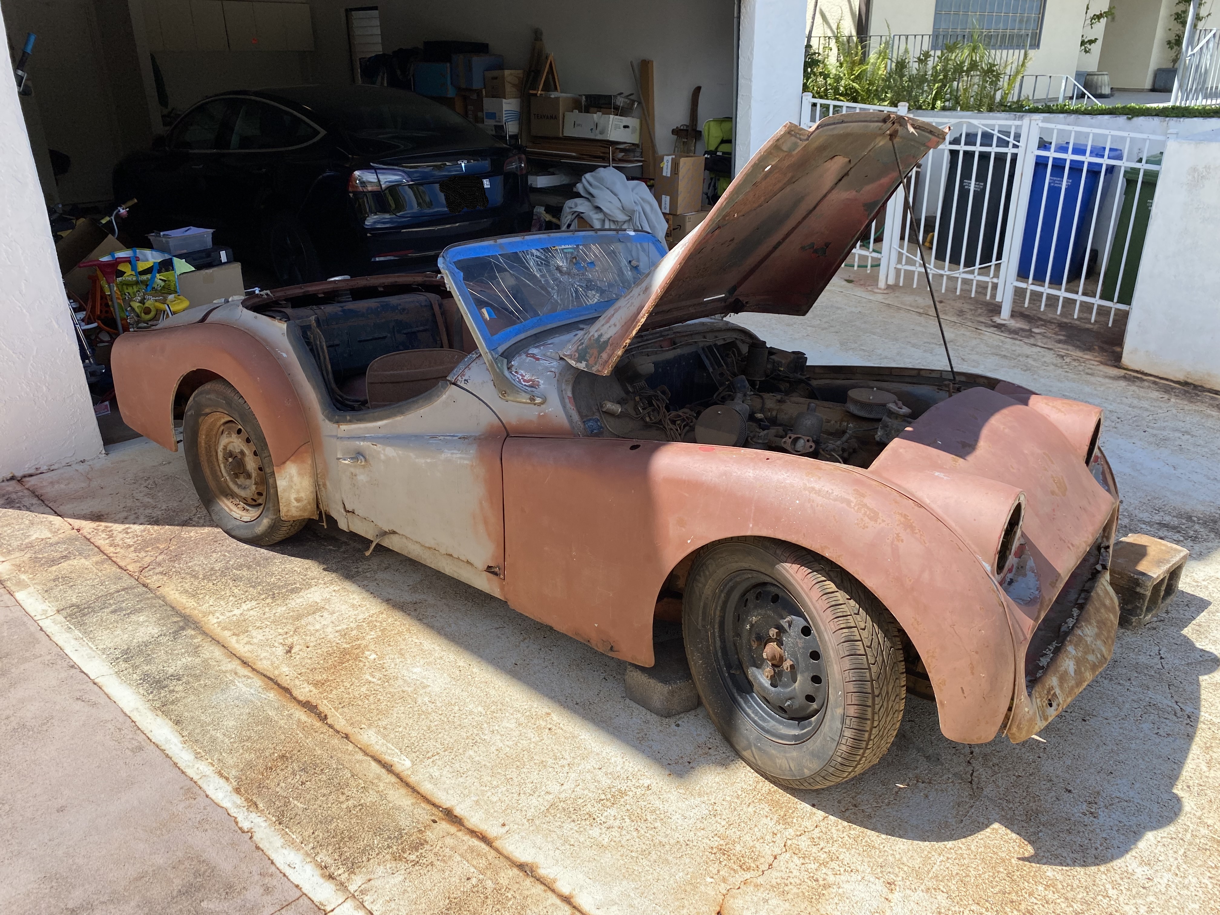

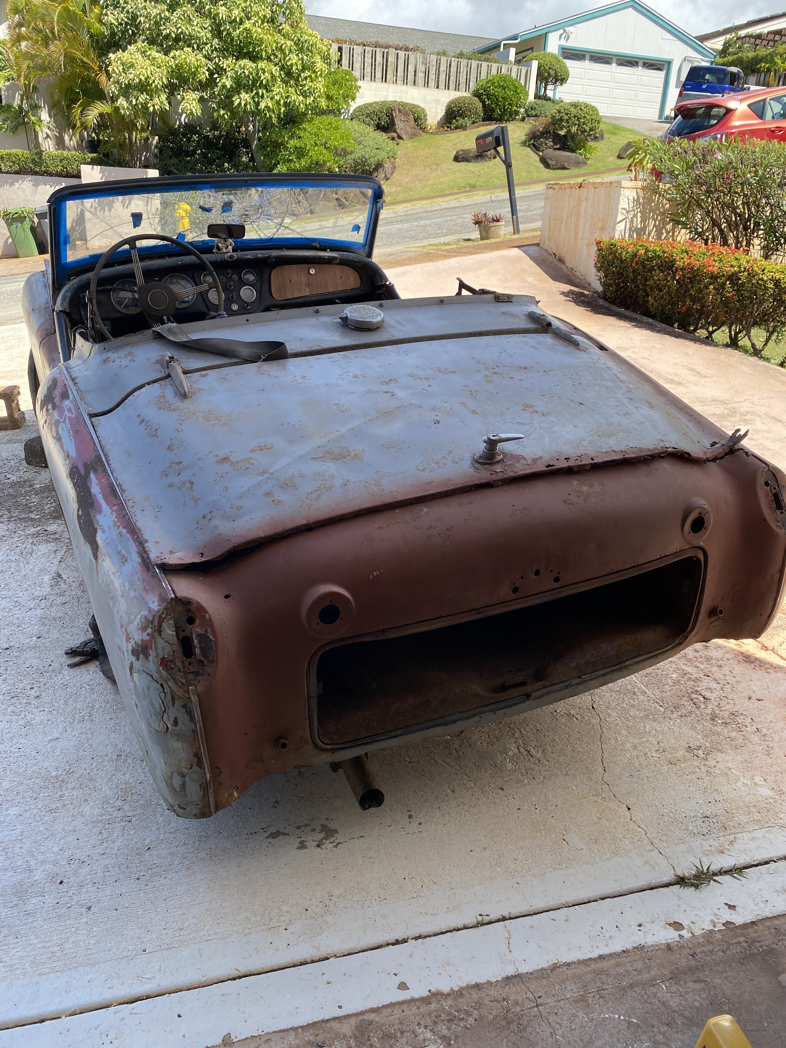

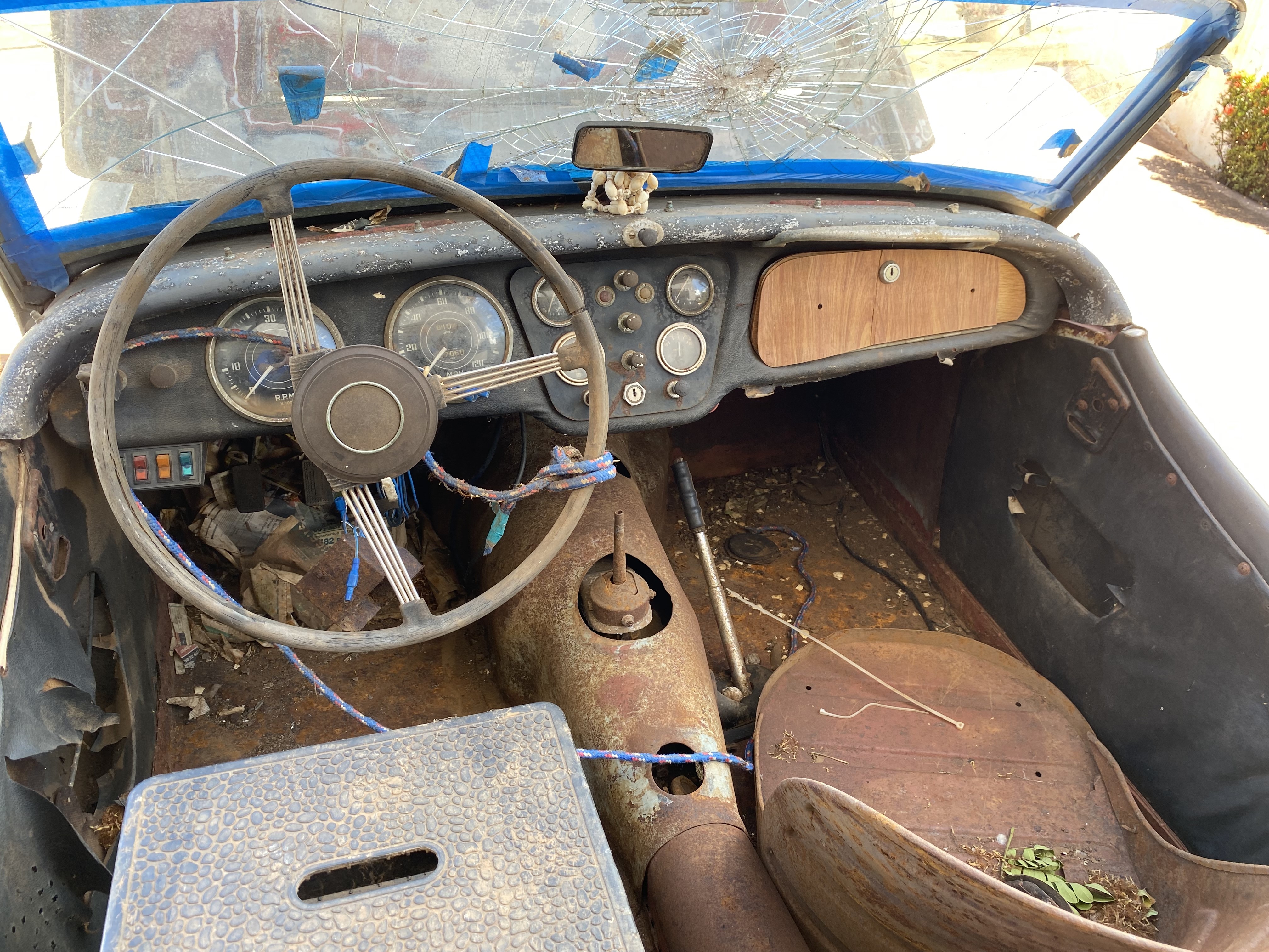

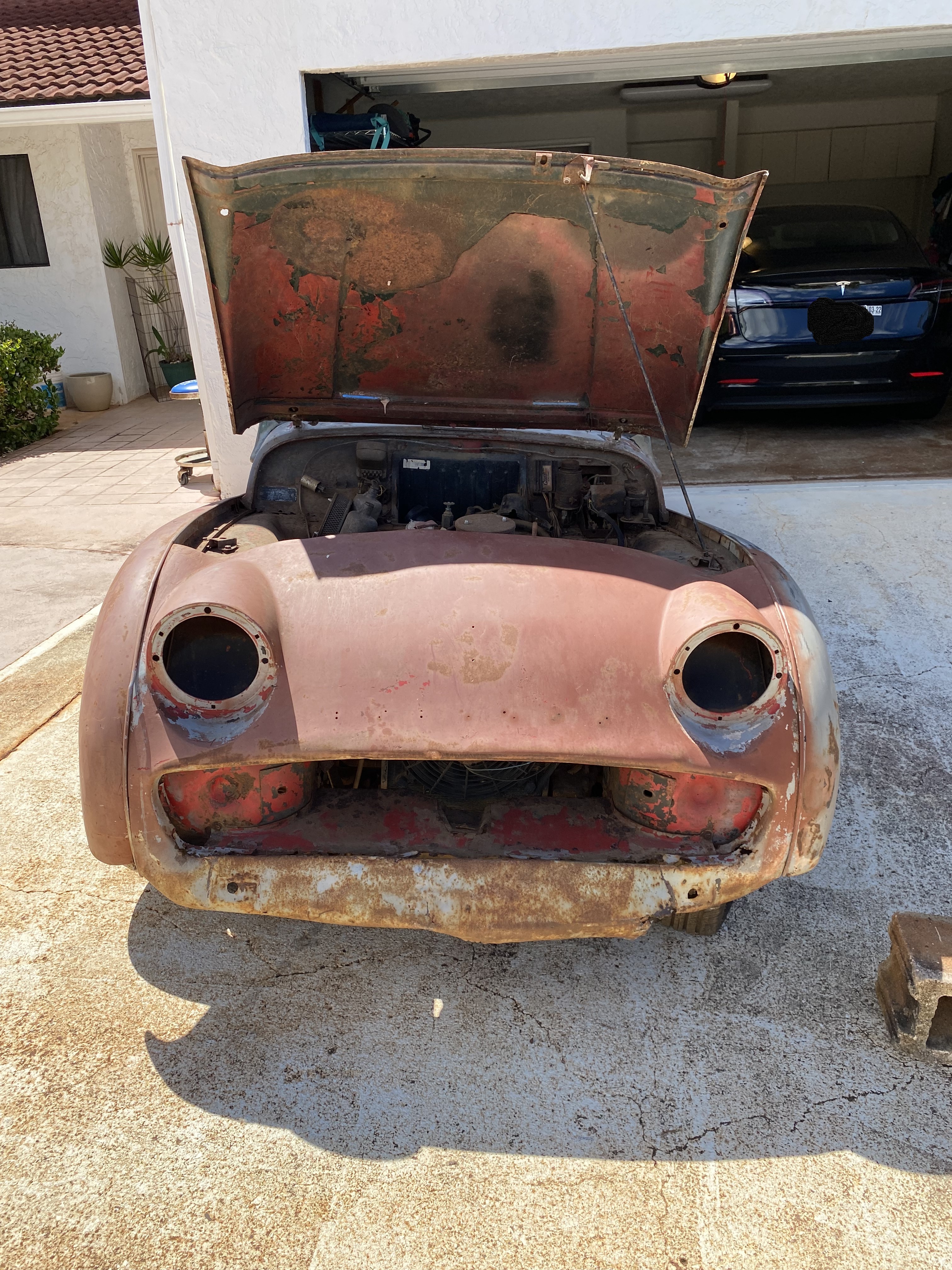

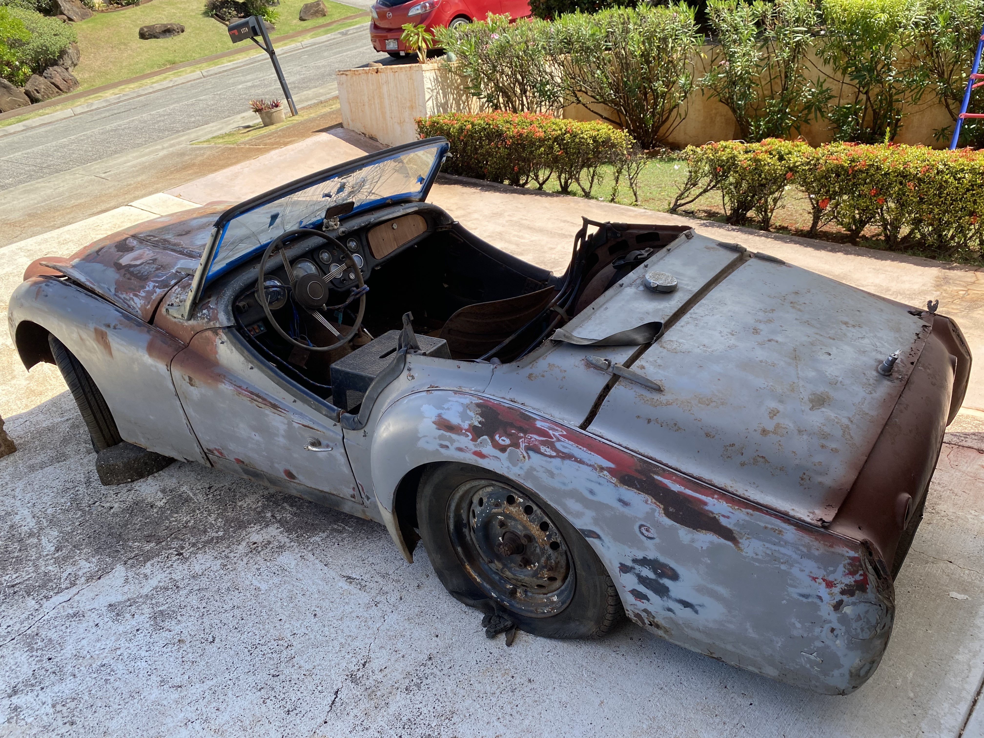

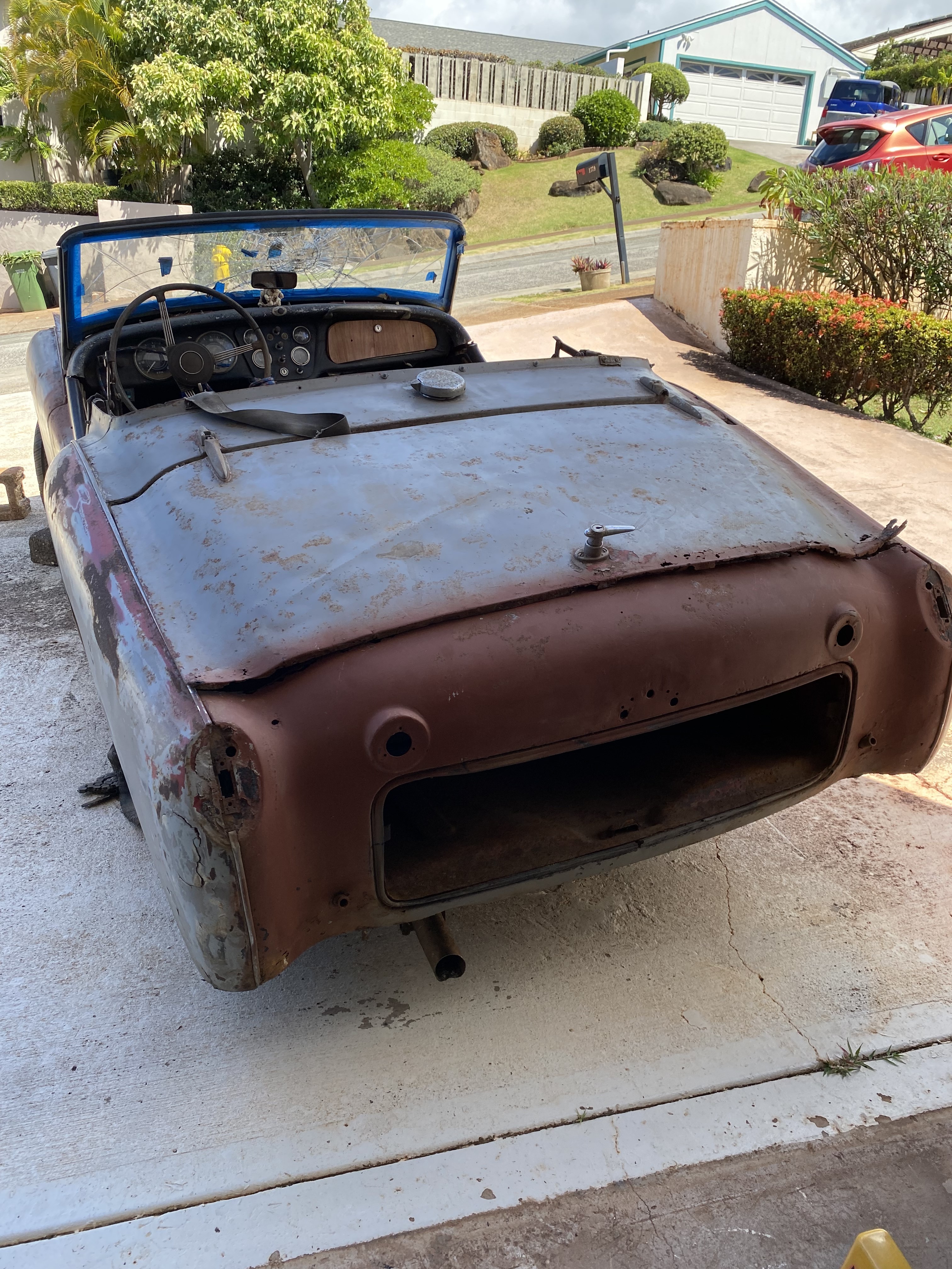

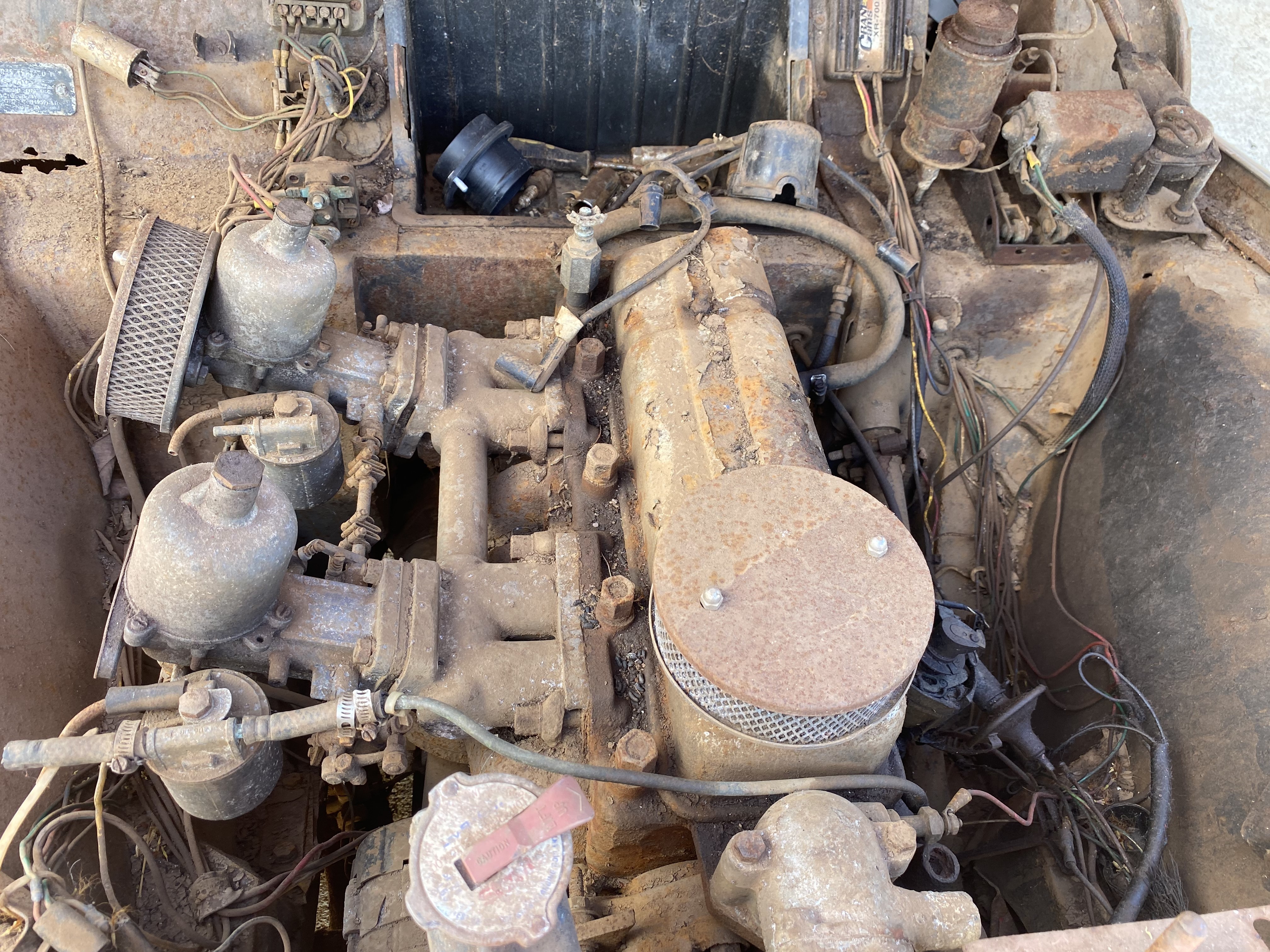

Hello all, I am super excited to begin this journey of restoration, and I am very greatful to have found this forum!
I bought a '61 Triumph TR3 that was sitting in an open shed for 6 years after a failed restoration had started. The Engine is missing most hoses and wires, but it does look complete and original. The panels had been half sanded, but several show significant rust (the worst being the front and the trunk). I think I have decided to do the body work first (although if that is a bad idea I am open to changing), but I don't know if there is an order I should be working through regarding taking panels off and working on them.
Any help or advise (or even derisive ribbing) would be appreciated.
Thanks from Hawai'i!
Jake

Step number One: Brush/vacuum out everything, get the rust/crud out of there so you can evaluate the rust/corrosion situation. You've got quite an adventure ahead of you!
Invite a fellow car-nut over to help you go through the systems. Join a local British car club and attend some meetings; you'll need experienced advice as you move forward. Browse through British car part websites, like Moss:
And once you've gone through everything and brought the mechanicals "up to snuff", I've attached a good summary of further steps to follow.
Keep us posted on how it goes!

Welcome to the TR world, it is generally considered a good idea to leave the mechanics and particularly the engine until last so you don't have a newly restored engine laying around not being run in for several years. It looks like you are in for a compleat body-off restoration so regardless of how much mechanical or bodywork knowledge you have I would get hold of a workshop manual and a copy of Enthusiast's Restoration Manual How to restore Triumph TR2 TR3 & 3A by Roger Williams. I put myself in the class of a Mr Fixit if man-made it I can take it apart fix it and put it back together and that has worked for me but I still referred to Roger Williams book. Even if you are not planning a Concours restoration these old cars have been played with by a lot of non-profetionals over many years and you will find nearly everything on it will need attention. This shouldn't put you off, you have a very exciting journey ahead and I wish you a pleasant and rewarding adveture.
Graham

Think of it this way. If the basic body ( car body minus fenders and detachable parts) is restorable then you have good candidate to restore. Fenders , doors and detachable parts are available used and some new. But if the basic body is beyond your ability to restore, then you need to think if the job is to big or to costly. That process is as stated earlier clean up what is there and especially get somebody with experience to offer their advice. If anybody is available. Or just do a lot of reading. After all, many of us that are restoring these cars had to start with some car. So why not this one for you?
Let the fun begin!!!!!
Charley

Thanks everyone for the helpful advise and encouragement! I have gotten all the junk out and vacuumed the dirt and dust. I will be doing a lot of reading and watching and learning! It both seems doable and insurmountable at the same time, but I will be starting small and slow. Thanks everyone!

Commision number?
Looks like it might have overdrive!

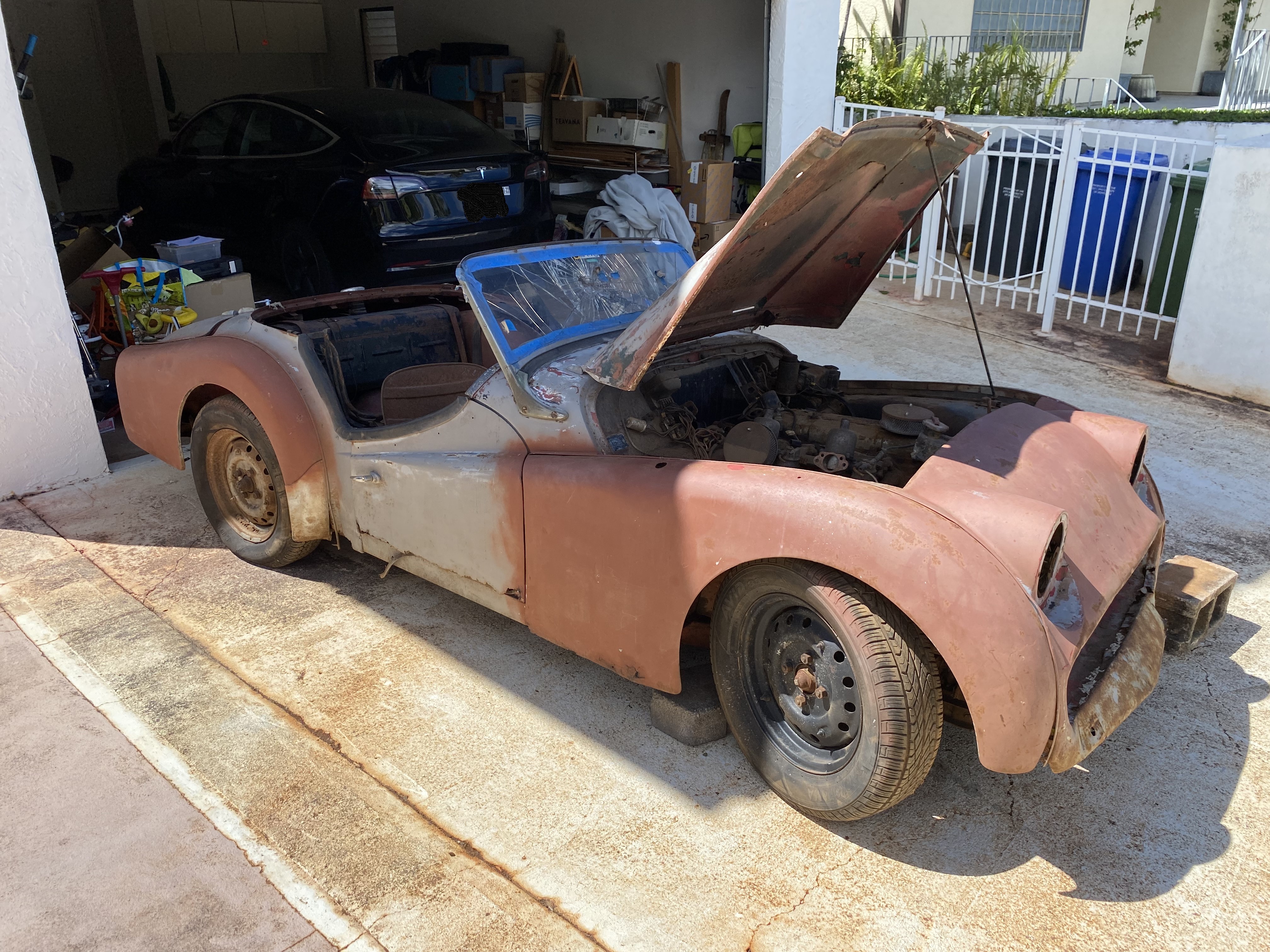

JakeView attachment 71873

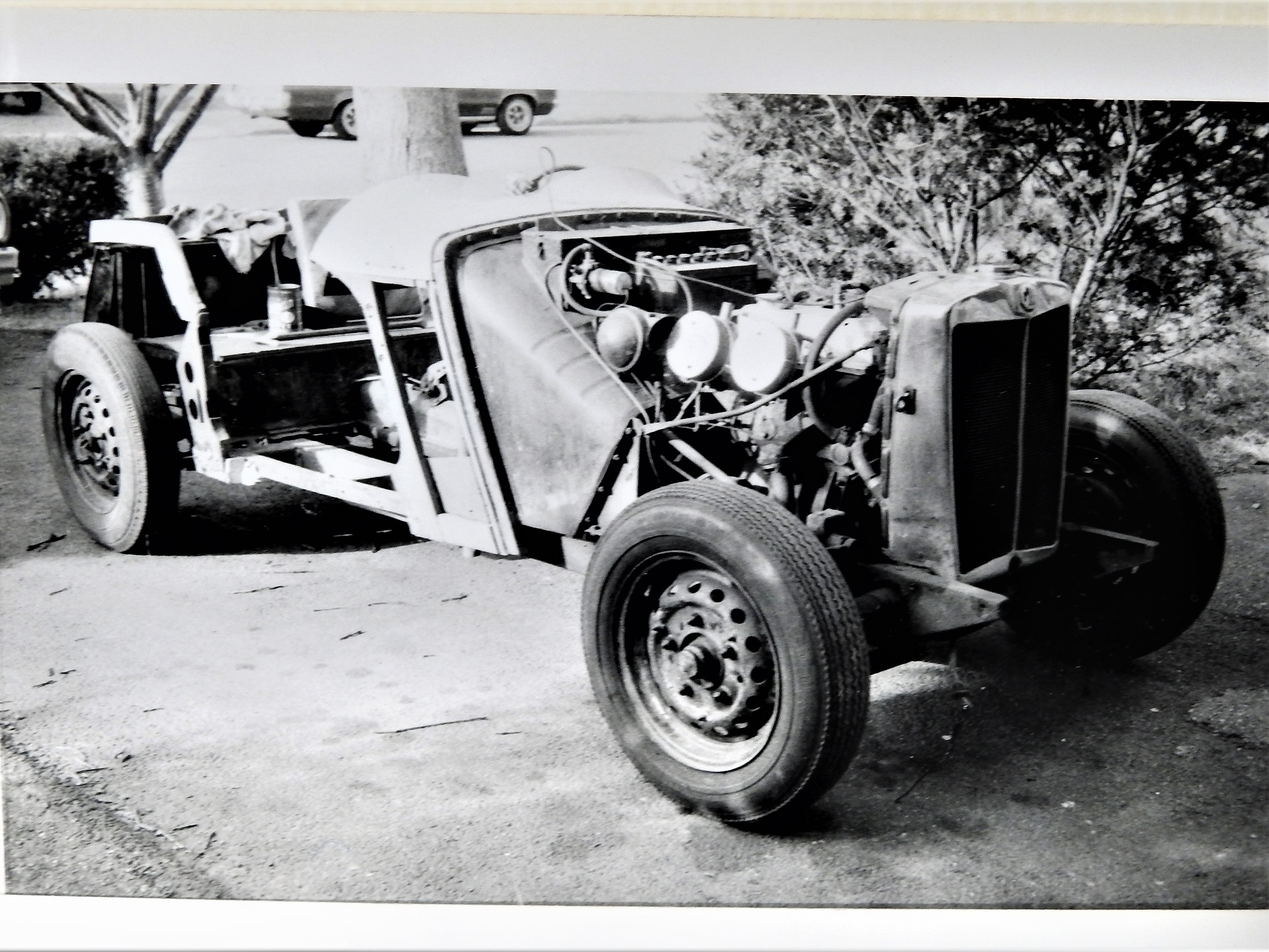

Jake: Three years ago I bought a '62 TR3A in similar condition. Perhaps a little worse. I joined the local TR club and asked for advice. A club member said I should first keep in mind "it has to go, and it has to stop." That has been my fundamental philosophy. In my experience, what you do will depend on 1) How much $$ you have to spend on it; and 2) What kind of shop/garage you have and what equipment/tools you have, which is determined somewhat by #1.
Mine was/is a rust bucket, and I taught myself to weld, after a fashion, to cut away and patch lots of eroded places. You can't hurry. Some things have been surprisingly easy (engine and tranny out) and some exceedingly difficult (new side sills). I should have taken it off the frame, but my own $$ and equipment limited me. I am about to refit the engine and transmission, and new wiring. We'll see how it goes. Enjoy.
