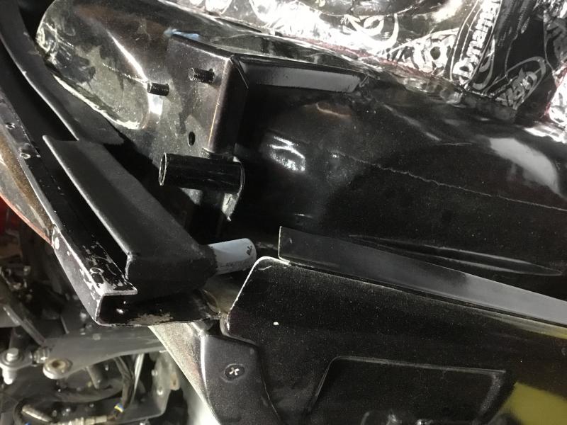

I was wondering if anyone had any good pics of the area where the pillar, shroud, and drainage channel meet. I think a piece may have been cut off the top of my pillars. I can’t figure out what the front of the chrome finishers screw to. Is it the drain channel? I know I asked a similar question about the drainage channel and how it fits in a few weeks ago and I appreciate all that helped. I can’t tell from those pics though how the chrome finisher and shut pillar seal get attached.

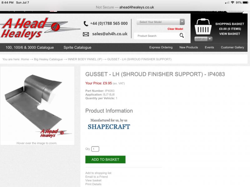

Your missing a piece off the top of the door shut face , thats what the corner piece screws into .
It extends up to the top of the drain channel area . There will be a gap between the shut face piece and the drain channel .
this is the piece your missing from AH4H

Wow, never would have guess that from everything I have looked at. I am going to order them today! Hopefully they won't fit like a jigsaw puzzle and I'll be able to tell how they go. Thank you very much!

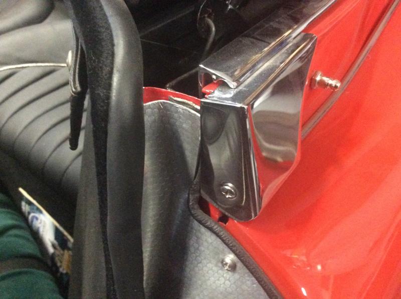

Looking at the pictures of what you have and what should be there. it appears to me that you are missing a section on the top of the B post. Your top appears level with the top of the rear wing (fender) whilst the other one shows that the B post extends up level with the top of the chrome sections.
