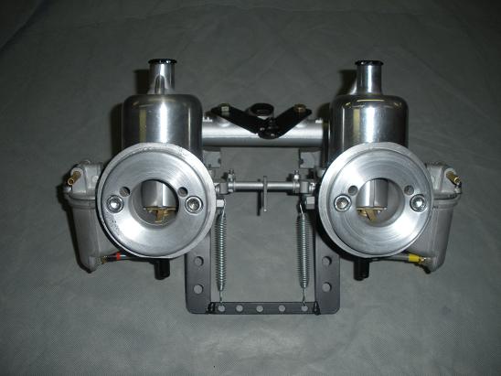

Yeah I open up the stock MGB velocity stack to 1.5", do so lathe work on it as far as putting a wider angles on it to get more air in, counter bore the mounting hole to run a KN RU-4410 cone air filer like we do on the SCCA race car, then port match the carb to velocity stack, so it get opened to 1.5 on the front side as well, thin the shaft a bit, and also put a knife edge on the butterlies, and radius the piston edge a bit to help flow at aprtial opening. Here's a set that will be similar to my street cars I doing for vintage race car, he waned built so if if ever wanted to put them back on street car he could, so we didn't thru bore them, they are still fully bridged.

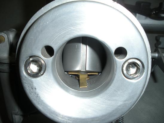

Here's set of Huffaker HS4s I restored a few months ago, they were thru bored.

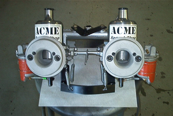

here's a close up of the stack and carb throat, notice the Huffaker jet wing, it was upposed to guide the air flow over the jet, which sticks up in a thru bore carb, also notice the bridge is completely gone, these were the hot ticket for track, but don't idle real good, so horrible for the street.
elvacar
Thanks
I saw another set that had extensive mods - soldered butterfly- reduced shaft - knife edged
and not thru bored - but a vestige of the bridge
the brass piece provided enough of an impediment in smooth flow as it almost forms a virtual bridge
