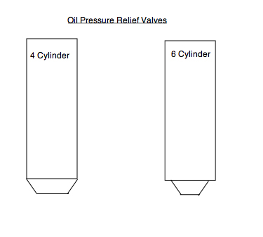

On speaking with my local engineer he suggested that the end of the pressure relief valve should be rounded and not like the one i have which is tapered, i know where this relief valve came from (a company known to me for getting things wrong) so i am now suspecting that i have the wrong valve.
I have tried to attach a picture of my one to let you have a look (although this is my first attempt at pictures so it may well not appear !) if not do you have a picture of a correct one.
Rob

Rob,
See the attached pic. I can't tell for sure from your pic but you appear to have a six cylinder valve which is stepped, as you can see. If we indeed are discussing the BJ7, this would be the correct valve.
We are still not sure that this valve is completely seating. To check, coat the valve and the seat with layout dye, rotate the valve against the seat & examine both for a full circle marking that shows a complete seat all around.
Not easy to do this in that small hole but with good lighting & the valve on the end of a tightly fitting stick the valve can be rotated against it's seat.
Best,
D

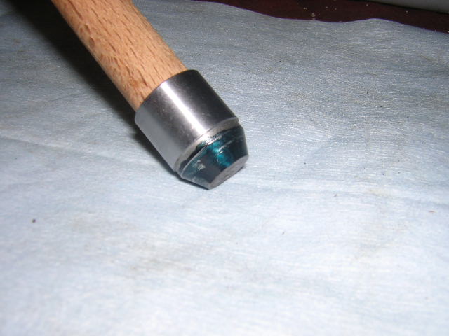

The first try of 0.160" was a convenient hex head bolt with shank that fit inside the spring to guide it & a head thickness of 0.160".
The second try was a piece of metal that I machined on my lathe. It had a short guide step which fit inside the spring & a larger diameter step of 0.360" long & diameter same as the outside of the spring. A step of more than 0.360" long caused spring coil bind before the plunger was adequately released. This on a BN2. See pic:
The six cylinder might require something other than 0.360" long. A bit of experimenting might be required. If you get the spacer too long, the spring will coil bind & the oil pressure will not be released & the pressure will go sky high. If the spring guide step is too long the same thing will happen. It just took a little trial & length adjusting.
As I mentioned, strangely, the shorter spacer did not increase the pressure enough to fully seat the valve but the longer spacer did. Don't know exactly what was going on in there.
D
