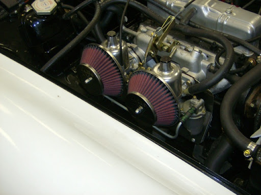

The European Midgets 1500 came form the factory with a twin HS4 set up, you see them on Ebay from time to time for sale, this would be a nice touch.
I've thought about the duals and even contemplated bidding on some in Scotland this summer - unfortunately I can't bring myself to cut the body after all the work done.
It's not likely to happen - but the idea of 4 carbs....
