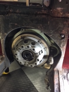

The starter solenoid on my 100-6 has a rubber covered switch that - when pressed - operates the starter. But, in order to get to it you have to remove the transmission cover and the cover in front of it that attaches to the bulkhead. Not to mention the carpet that covers it...
Not exactly an easily accessible feature! Anyone have any idea why it is located there?
Well...that makes much more sense! But as you can see from the picture, the existing hole indicates that it's mounted in the intended position on my car....go figure!

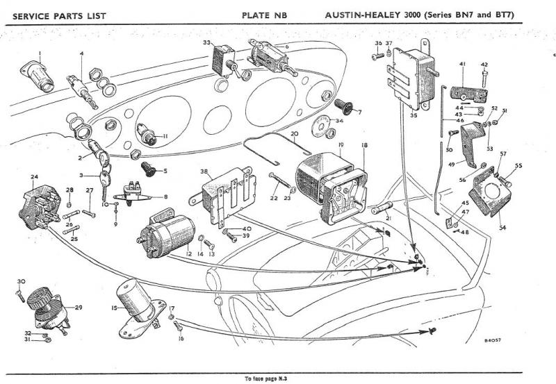

All of the 6 cylinder Healeys I've ever seen have the solenoid in this position (With the hole) as shown in the BN7/BT7 parts list (#12) below. On my cars, I can easily push the button with my finger from the engine compartment to turn the engine over. (Valve adjustments, etc.)
