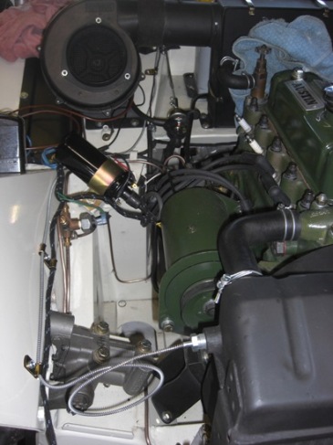

Running the original gen. On my first start up, the gen. gearbox seized up, and it was thrown across the garage. Major heart ache. Lucky I was on the carb side of the car.
I replaced the std. contol box with an electronic one. No problems so far.
Scott in CA
