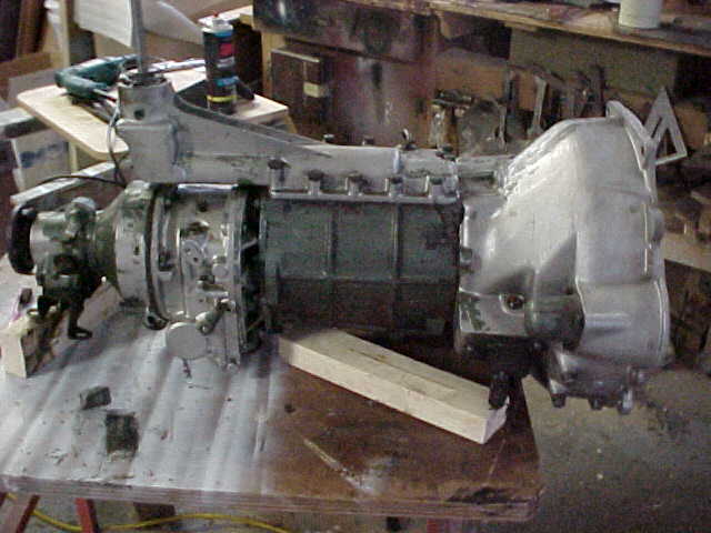

marka, i agree, good point im going to start my trans. rebuild today (i hope) when done ill also be using "red" line! /bcforum/images/%%GRAEMLIN_URL%%/iagree.gif
