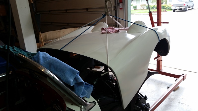

gfholl
I used an engine hoist which worked well. I would have been more nervous if I had a nice paint job though.

I used some old Sailing Hardware and Line I had in the garage. On each Fender was a mirror hole. I inserted an Eye Bolt with a backing washer on the end into the mirror mount hole. Two ropes went to each side with an S Hook on the end. Ropes met in the middle to form a bridle which led to a single rope running up to the Beam in my garage. With my 7'+ Ceiling in the garage not a lot of room but rope went through a pulley and I installed a cleat, again more spare old sailing hardware so I could clamp the hoist rope wherever I wanted. The spacing of the Mirror Mount holes pretty well balanced the bonnet. I learned I could raise the bonnet fairly level rotate it 90 degrees so it was clear of the fenders and lower it onto the back edge/corner and then stand it straight up on a piece of carpet or cardboard and then rotate and move as needed after I disconnected the S Hooks.
A similar setup can be found to raise and lower Miata Hardtops into place, or raise bicycles up to the ceiling for storage. Really pretty simple. Again the same setup can be used tp install hardtop by yourself, just back the car onto the garage. Have a helper ready the first few times you try it. Again helps not to have really nice paint if doing this by yourself.
On Bugsy IV I will make this a 3 point or maybe a 4 point bridle and will use two screw mounting holes for the hood hinge on each side to anchor the hoist ropes. and figure out a similar arrangement for the front. Bugsy IV will not have fender mount mirror holes when painted.
