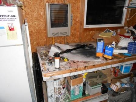

Here's a shot of my steering rack after being stripped and resprayed. a few noticeable differences in garage layout however :smile:
