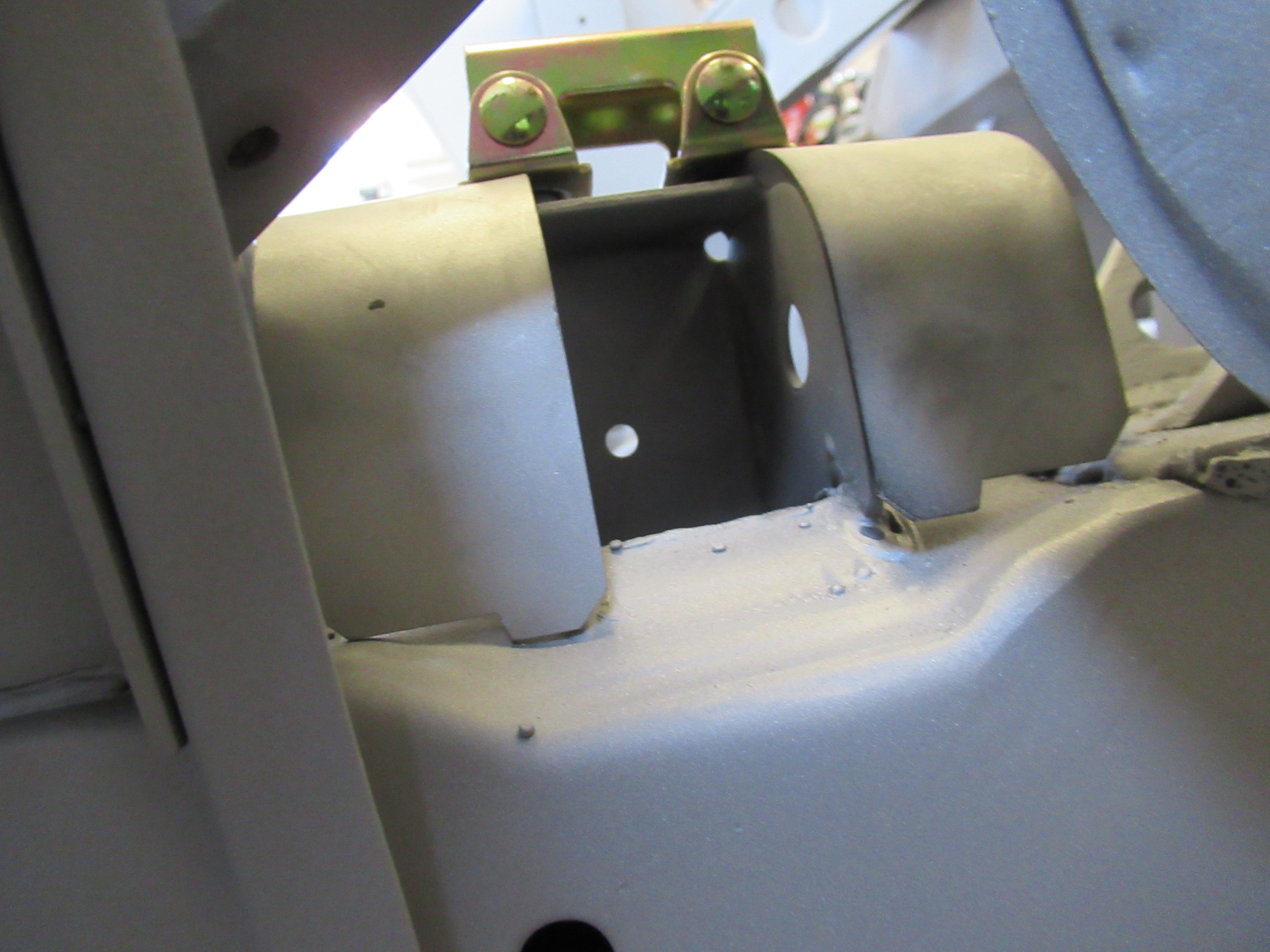

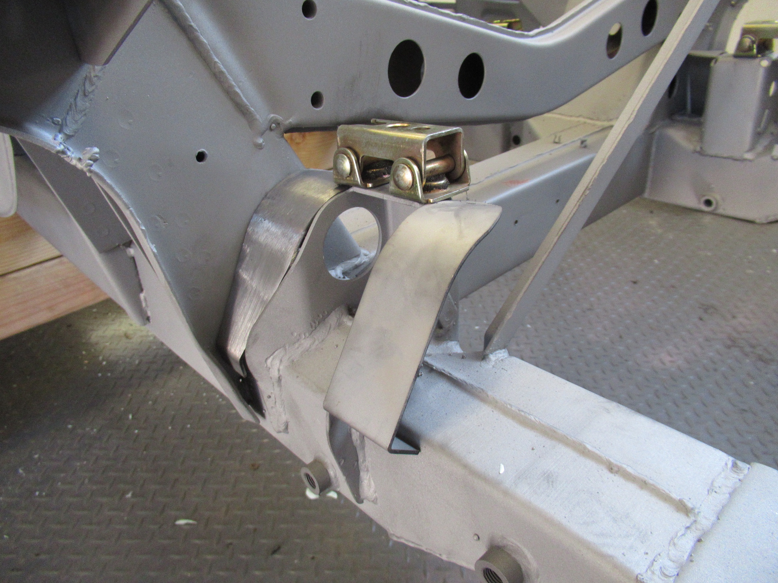

Okay took a few pics. As I said, I "think" I have them in the right places.... albeit some will require a bit of forming for a better fit before welding, but I expected that. But sure would like to get some verification of the placement from someone that has already installed them.
They make a lot of sense to me as the Vredestein 185/70x15 tires will put considerably more stress on the front suspension mounting points than the original skinny bias ply's.

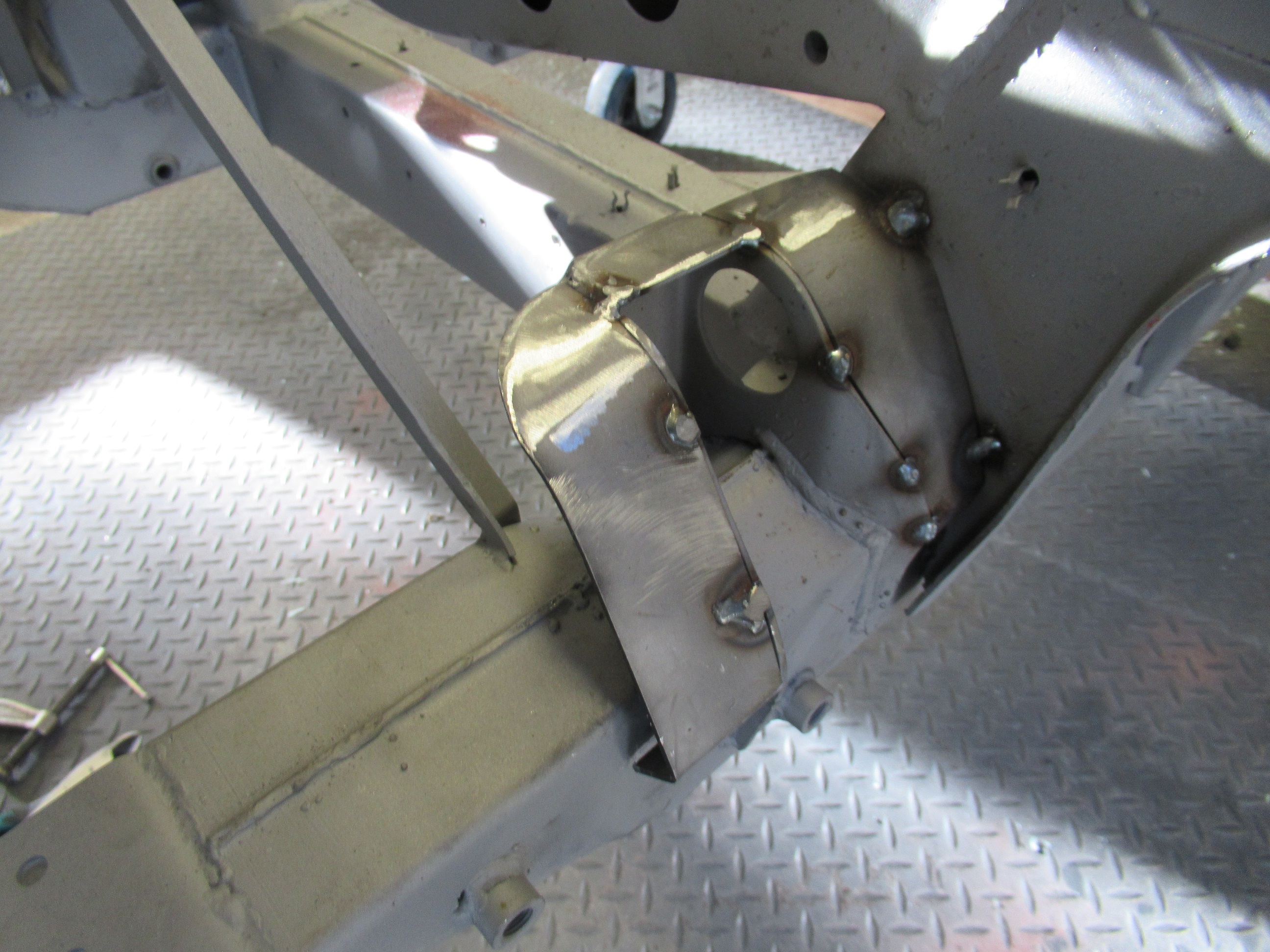

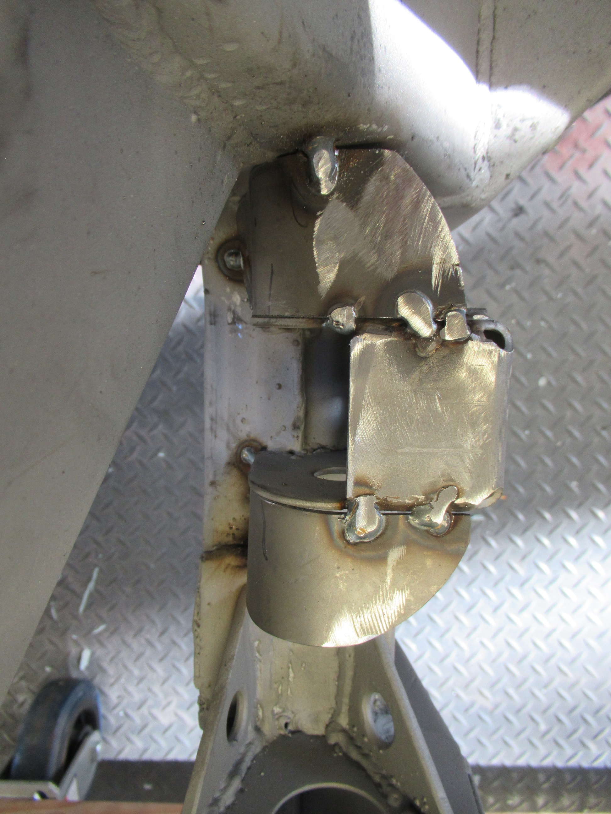

Well, after revisiting the placement... decided they were good. So, spent the afternoon doing more precise fitment and then tacked them in place. By the by, my vice, bench grinder and table belt sander were all put to good use to get the final fitment.
Added some pics... tack welded in place... not pretty .... yet... but you get the idea. This is the left (driver's side) the right side is a mirror image of these.
