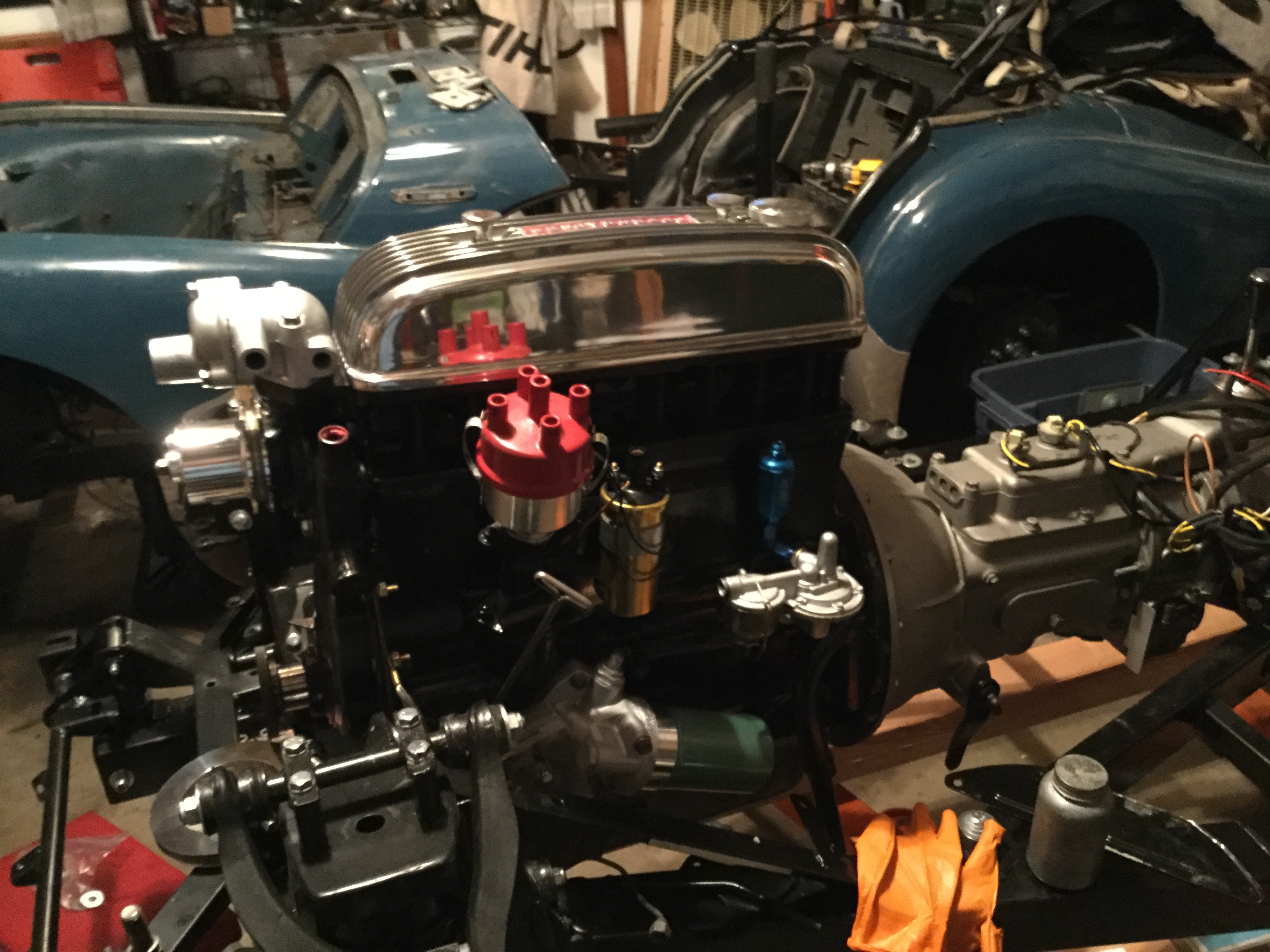

when I redid mine, I used heavily used RTR components, including the upper trunnion kit to remove the positive camber and add positive caster. I did have the body off, though. You can see the rebuild in the attached. No pix of the suspension rebuild itself. Sorry…. Jim
