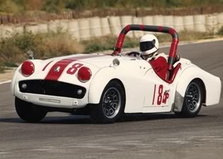

TR2/3/3A The "air vent"on the lower part of the front apron below the grille....
karls59tr
Bronze
....you see these on racer TR3's because the lower part of the apron blocks about 1/3 of the air flow to the rad. Does anyone know of a source for these "vents?

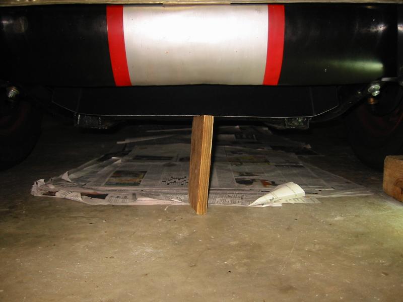

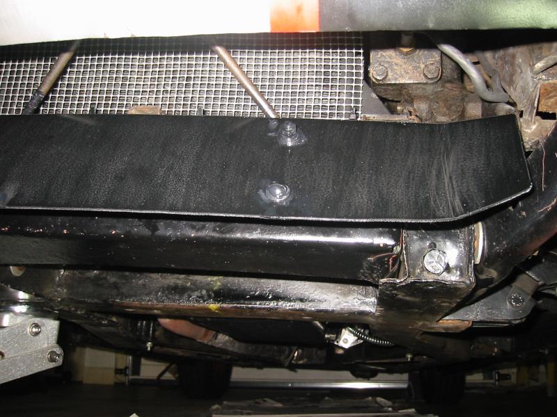

Please post picture of where you placed the holes. Thanks! Also, would an air dam in the front do the same thing? I fabricated an air dam and it seems to direct air to the lower part of the radator. I attached some pictures.
Regards, Bob

I'm having no luck posting pictures but maybe tinman has a photo he can post? An air dam would work to get air to the lower rad and you wouldn't have to cut the apron.
