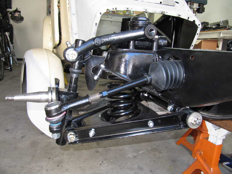

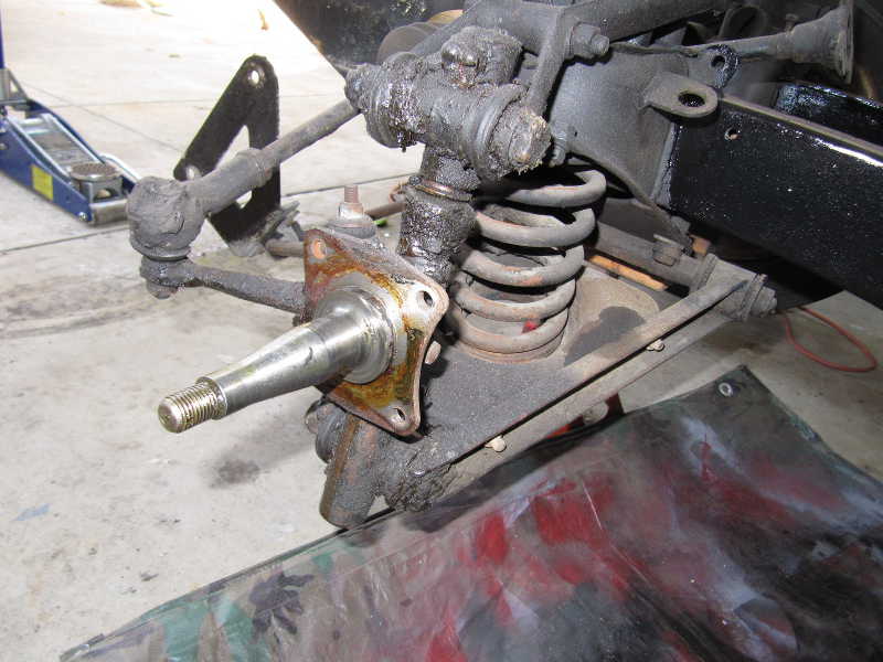

I'm just finishing the front suspension on my TD. Amazing how similar it is to the MGA and MGB. Fortunately (I guess...) the thing was embalmed in old grease, so it came apart fairly easily. But, from other efforts, it's pretty clear to me that suspension parts can be difficult to get apart, perhaps more so than other components. You really need the right tools and a willingness to use appropriate force. You just need to know when it's appropriate, and how to apply it.
BTW I had the shocks restored by PeterC. If their operation is even a tenth as good as they look, I'll be thrilled.
