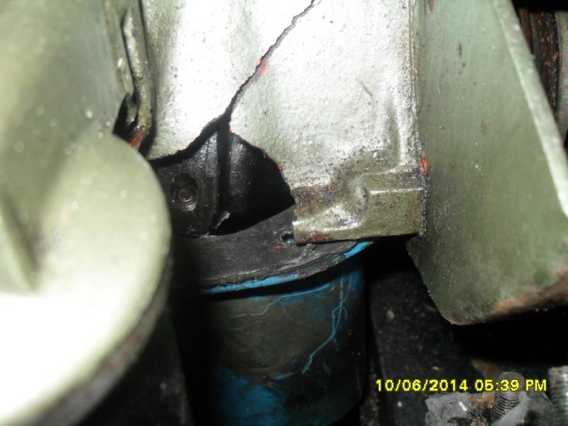

Finally figured out why my Midget Mark I's engine locked up last September. Ouch! No warning, it was running wonderfully, no knock. Metal fatigue in my 948 engine block? Time to do a "Grapes of Wrath" freshening on the locked up 1098 engine I have in the garage and drop it in. These cars are so much fun when they work but I might be ready for a Miata. What to do?

I've never seen one break that way. Are you sure it wasn't hit by a loose rod or a broken crank?. 948 blocks can often be found free or very cheap. I used to have several, I think down to one now. I have a 1098 that's been machined to take a 1275 head, but otherwise, only hanging on to 1275 cores.

Yes, the entire episode is strange. I don't think a rod went through the block. There would have been oil and smoke everywhere and there wasn't. I think a broken crank would have kept running. This came out of nowhere. The car was running well then all of a sudden locked up. I think I will take a little time and consider my options. I have a locked up 1098 CG engine but if I have to put money and work into it I might as well get a 1275 engine. Or if I take my time perhaps a running 948 long block. I had a ported and polished 1098 head on the 948 and was pleased with it.

I thought it might be a broken timing chain until I saw the chunk missing in the block. Also I think if the timing chain broke the engine starter should still spin the engine. This lump locked up. No bang, smoke or oil spray.... nothing.
At least I know what has to be done. The easiest way to go would be to get a running 948 long block. It shouldn't be difficult to get the car back on the road.
