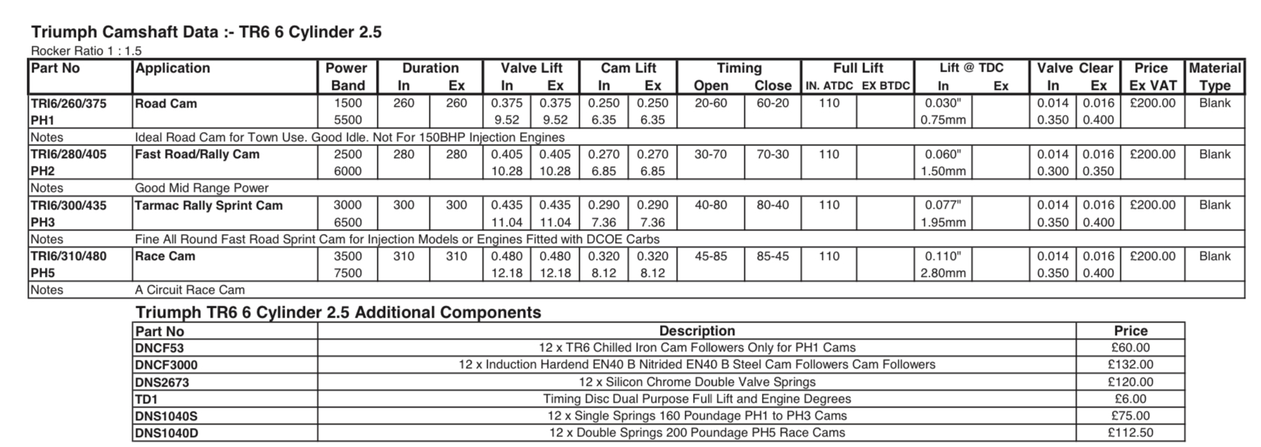

This is from the Newman Cams website which my BP 270 cam from BPNW is a Newman cam. Presumably by the descriptions of the cams mine is the first one and valve clearances are listed although they are all the same. This being for a TR6, mind you…

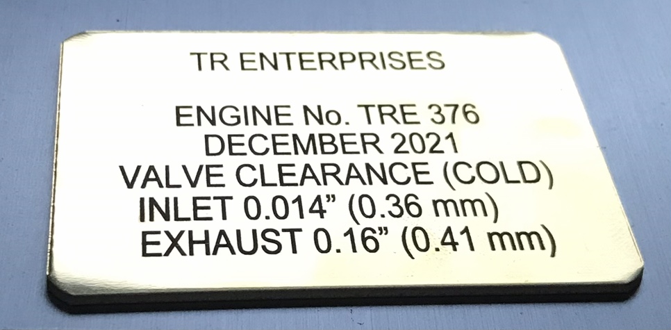

my old 87mm engine ran 12-14 gaps
My new engine has similar to the 300 cam spec and runs 14-16 gaps
So very cheap engraving place created this for the top of the rocker box
