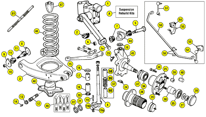

yes, front suspension. This is the part that the wishbone attaches to the car. the fulcrum pin goes through the front bracket, into the wishbone, then into the rear bracket. Everything is locked in place with tabbed washers.

We have Wishbones, Swivel Pins, and Swivel/Stub Axles, trunnions and Inter Fulcurms.
I know about A arms (wishbones), but which part is the King pin (is that the Swivel/Stub axel?), so where do these shims go?
I saw no shims when I took these apart nor are any seemingly listed in Moss, VB, or Hanes.
The kingpin is #4 in the attached drawing Jack. I'm not sure what you would call it but years of working on Old Ford Pickup trucks left me with only the term kingpin to label this. Course to me a trunk isn't quite yet a boot either...lol
JC
Jack, the shims go on top of the swivel pin, kingpin, whatever you call it. If you didn't notice any when you took it apart, they often stick up inside the trunnion cavity.
Jeff
Okies, yep noticed but only one. and yep they are still on the pins as the whole works gets replaced. Wishbone, trunion, and Swivel pins and all the bits, both sides. This stuff being tight and right is vitle to the handeling and safety.
