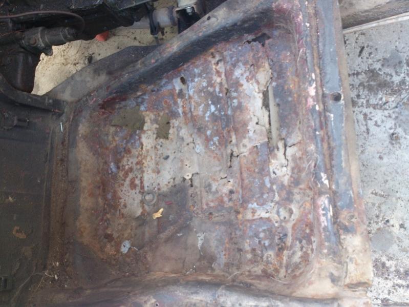

drivers floor (800x600).jpgall apart (800x600).jpgWell getting everything apart was not to difficult but now I have run into a real problem. I spent the day going around to different body shops trying to find someone who could weld me a new floor. Basically all the local shops looked at me like I am crazy and said no. I also have tried to get any sort of welder and it seems to be impossible to rent anything other than an arc welder so I can't do it myself either.
Now the biggest problem is with the drivers side floor which has huge holes. At this point, I think I am either going get a large of sheet metal and pop rivet and glue it in place with polyurethane type glue.
Anyway any ideas as to how thick the sheet metal should be? Better to put on on the top or bottom? At this point I am so ticked off with the whole thing that if someone came by and offered to take it I would give it to them :blue:

I agree with Tom above, you need to find the right shop or individual. The floor replacements do not require advanced welding skills. Although most of us have done pop rivet repairs they are much like putting duct tape on a leaky hose; not a permanent repair. By the way, original sheet metal was 18 ga. Perhaps you could also describe "everything apart." If you are really into it, it may the time to do it right.

How about laying down some fiberglass instead? I've used it before and been quite happy with the results. Easy to apply, can't rust, and as strong as you'd like. Put down one layer and let that harden, then add more layers as you see fit. It will easily bridge small gaps. For larger gaps, you can glue the dry cloth in place over the gap (using resin for glue), then go back and add another layer once the "glue" has hardened. Or use a piece of screen wire to bridge the opening.
For smaller patches in awkward places, I find that epoxy (JB Weld) works better than fiberglass resin. Start with a piece of plastic (like an old Ziploc bag) and coat one side with JB Weld, then lay the fiberglass cloth over it. Butter the surface where you want the patch with JB Weld, then stick the patch to it. The JB Weld will penetrate and lock into the cloth. After it hardens, you can usually just peel the plastic away. Or sand, file, etc. the surface to shape as desired.

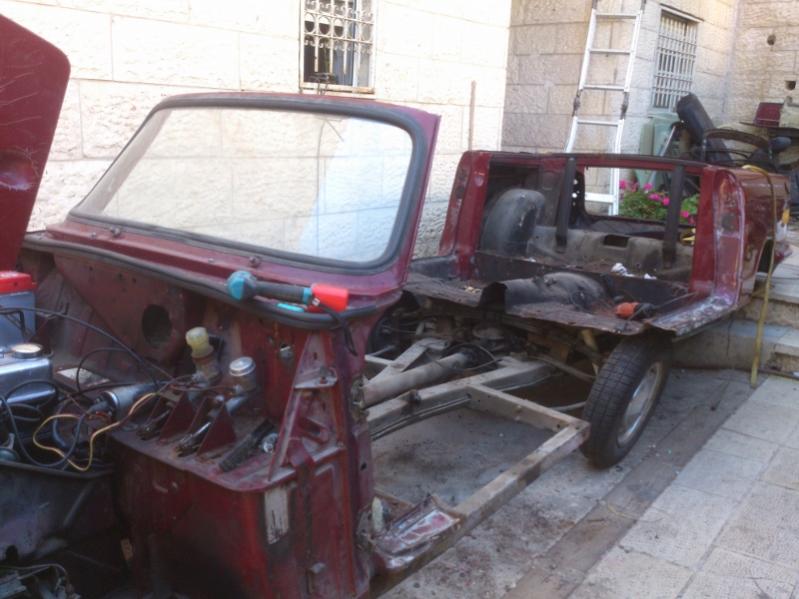

I added a picture, to give an idea of "everything" off and there is even more off than in that picture. Basically I have stripped the bulkhead down to the rusty painted metal with no accessories.
I actually stripped out a nasty layer of fiberglass that was not attached to the metal I have no idea it didn't stick because it wasn't applied properly or was put on dirty rusty metal, but it was basically just siting on top of the metal trapping moisture in place.

It looks like you have a substantial project ahead of you. I don't know what your time frame is or what you expect the outcome to be and more importantly, what your budget is. Sending it to Russia or even hiring a restorer in Israel will be very expensive. Getting help with the welding, if a welder can be found, has it's drawbacks too. Much cheaper, of course, but you are at the mercy of the welder getting everything to fit.
Have you considered DIY? Parts for the Herald are available and not too expensive, at least before shipping charges are added in. A new floor pan cost about the same as two hours of welding and a gas MIG welder costs about the same as two floor pans. Welding in new panels is not all that hard to do.
