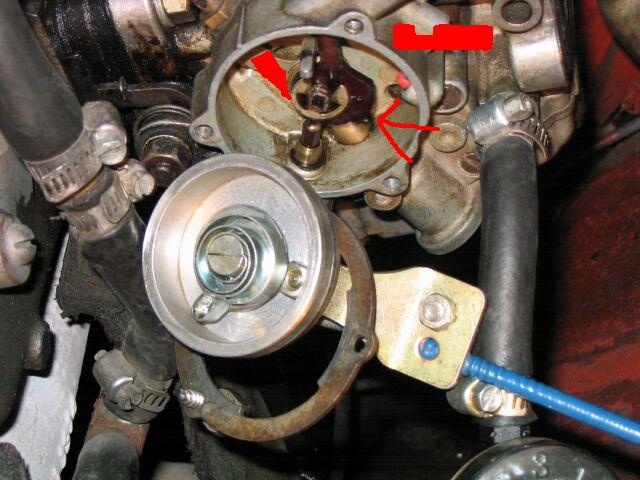

Here's a pic. Can someone explain to him how exactly it works? Dahubby can fix anything, once he knows how it works, or is supposed to work. All I know is that with the choke apart, and the cable off, the car started immediately. No 25-30 tries.

Looks like the old Solex choke on VW's. As the metal coil heats up, it uncurls and turns, moving a pin which moves the butterfly. Not sure if that's what you've got, but looks like it.

You missing a piece. There is a metal pen that goes where the red is on the attatched file and it comes out of where the red arrow it. It look like the little red drawing I made from the side with a notch cutout of it.

Looks like you have the stromberg waterchoke that has been converted to a manual choke. The site from my other post https://www.paulbunyan.net/~jasko/choke/ will cover pretty much all of it but the modified part which is the part where the choke cable goes to. On the water choke that piece would be similar but instead of a cable uses the temp of the coolant to adjust the spring and thus the amount of choke.

I looked in my Bentley and didn't 'see' that part you drew for me in their diagram adam. Could it be that part was never there? Is that a crucial part?
A converted water choke? Is that a bad thing?

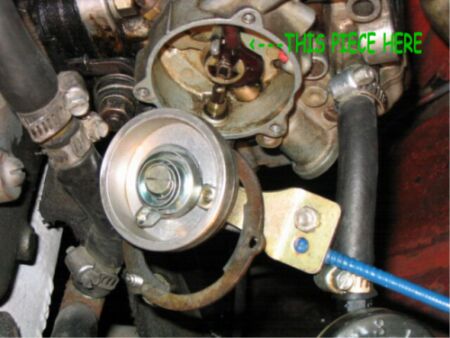

See pic. That red pin thing by the arrow should move when I open the choke right? But it hits that metal pin to the left of it and won't move. Wants to, but can't. I mean, when the other piece (that has the cable on it) gets screwed back on correctly, that pin can't move because it hits. It's like it should go on the other way or something, or be on the other side of that other pin (are you confused yet?) so that it has the range of movement it needs.
Does that make any sense? And could this be part of the problem?

Just so everyone knows I'm haven’t posted anything tonight /ubbthreads/images/graemlins/smile.gif The red piece is the fast idle cam. On the stock water choke as the car warms up the spring pulls on the pin (see pic) allowing the cam to move counter clockwise and lower the idle. The brass piece at the 6 o clock position from the pin is the fast idle pin. It holds the fast idle cam in place at idle. From the look at your picture the pin you’re talking about is in the no choke position. If you open up the throttle so that the fast idle pin (should be spring loaded and move away from the cam) is no long touching the idle cam the pin you described should be able to be moved clockwise. If it’s still not moving you may have found the source of the problem. #3 is the fast idle pin.
Oh, I'm sorry guys I was looking for the pin on the wrong side. It is there. Oh and if you take off the choke actuator, then it is set to "on". I don't think it is adjusted right.

Hood's open, dahubby is under it, has tools in his hand and he's grumbling. That's a good sign, right?
It starts! YAY! Also replaced the vacuum hose (which had nothing to do with the problem) and a couple others while he was under there. Idle's about 850-9, fires right up.
What'd he do? I asked that. He said, "I fixed it."
IF she starts up first turn tomorrow morning, I'm going to let that man go fishing next week!
