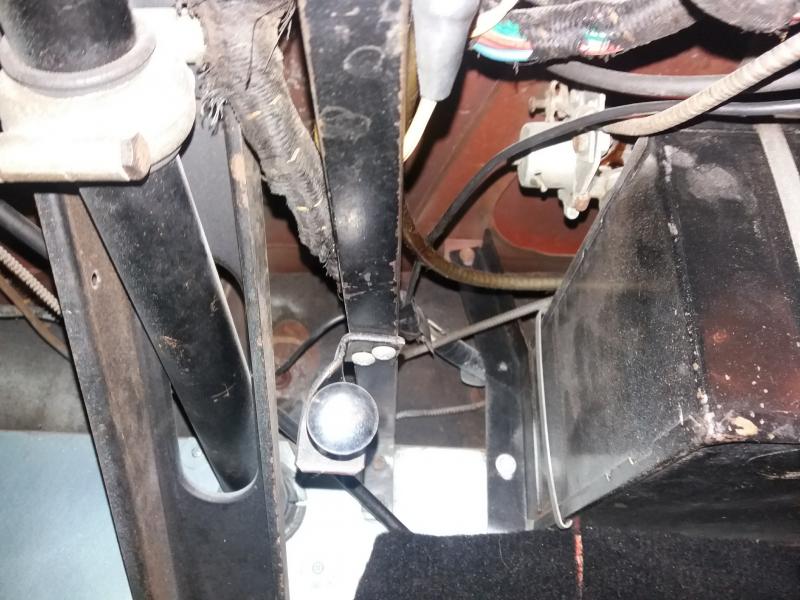

On the mark 1 AH 3000 Where is the choke bracket affixed, i took a photo at Ah spares who had a mk1 in their show room photo attached and it seems to be affixed to a bracket , but not sure if this is correct or a after mod, i know on the mark 2 it was in the dash board.
Anyone with a mark 1 who could advise,
Mine is now right hand drive the photo is of a left hand assume it would be in the same position?

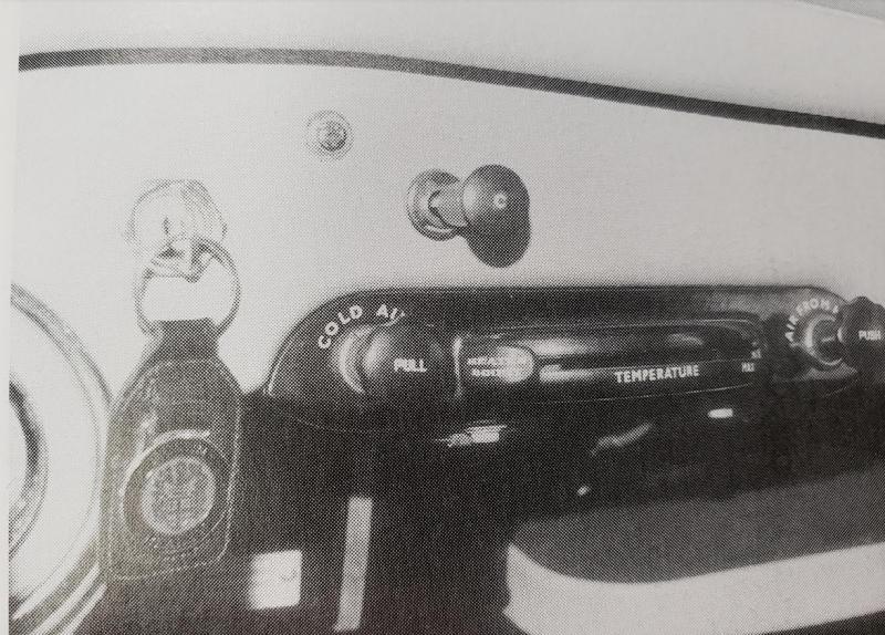

That's the original location of the choke knob on a 100-6. On a 3000 Mark 1, if it has a manual choke, the knob is on the dash above the cold air "Pull" knob.

My 60 BT7 is 4422. I have had it since 1971. The choke was under the dash on my car as in your photo.

My '60 BT7 is 4646 built date 15-17 September, 1959 and had the thermo-electric choke when I got it in 1987.
I promptly removed the thermo-electric and mounted a manual choke as in Phil's picture.
According to the Clausager book the thermo-electric started with car 2194 and ended with BN7 5234/BT7 5310. When they discontinued the thermo-unit n Nov. 59, they placed the choke in-dash like Steve's picture. It doesn't say for sure but presumably prior to 2194 it was probably under the dash like the 100-6 predecessor.
