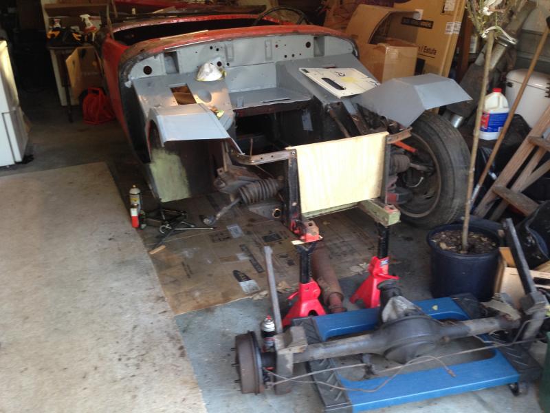

Jim_Gruber
attachment.php
Who has a copy of the Bringing A Spridget Back to Life Checklist / Link for Mike. That's a start.
Mike,
These cars are not all that hard to bring back and even more so a ton of fun to drive. It all depend on your ultimate plans for the car. Show / Concours quality doesn't come cheap but almost all of the parts are readily available. I purchased a Bugeye in boxes that was taken apart 35 years ago to have metal welded in to cure tinworm / rear clip issues and it never got put back together. It's ready to go on a rotisserie so I can take it upside down to clean and paint the bottom and do some additional welding work. New brake lines to be installed while on the rotisserie. Upgrades to include: 1275, 5 Speed Kit, Disc Brakes, New Interior, Front Tilt Bonnet, new Wiring harness, Speedhut GPS Speedo and Tach, and a whole lot of other goodies are planned. it just takes time to get it done. Working full time still is interfering with time I can work on this project. I want to have on rotisserie and rolled out and pressure washed in he next few weeks so I can do lots of other projects in the garage as temps allow this winter.
Welding and Bodywork as time allows this Fall
Seats and Dash work in the basement when it gets too cold in the garage.
Take a looks at the Bringing A Spridget Back to Life List. That is your Step by Step Project Plan to what it will take to get it done.
Jim_Gruber
Just realized that is a really old picture. Current state is a totally stripped front end. I count only 12 screws / bolts that could be removed and all of those involve door hinges and latches. Everything else is off of the car.
