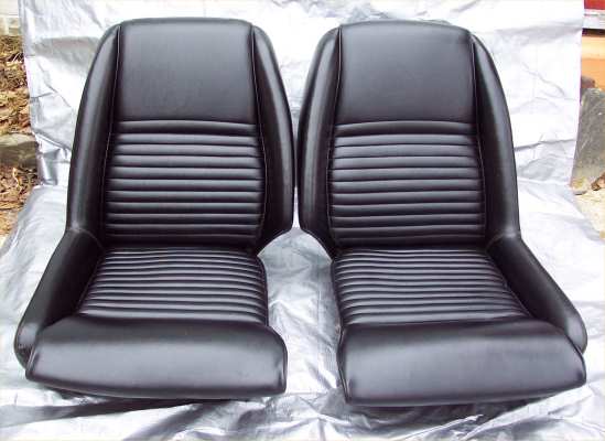

GT6 MK1 seats that I sold in 2004

PeterK, Those seats are nice!
