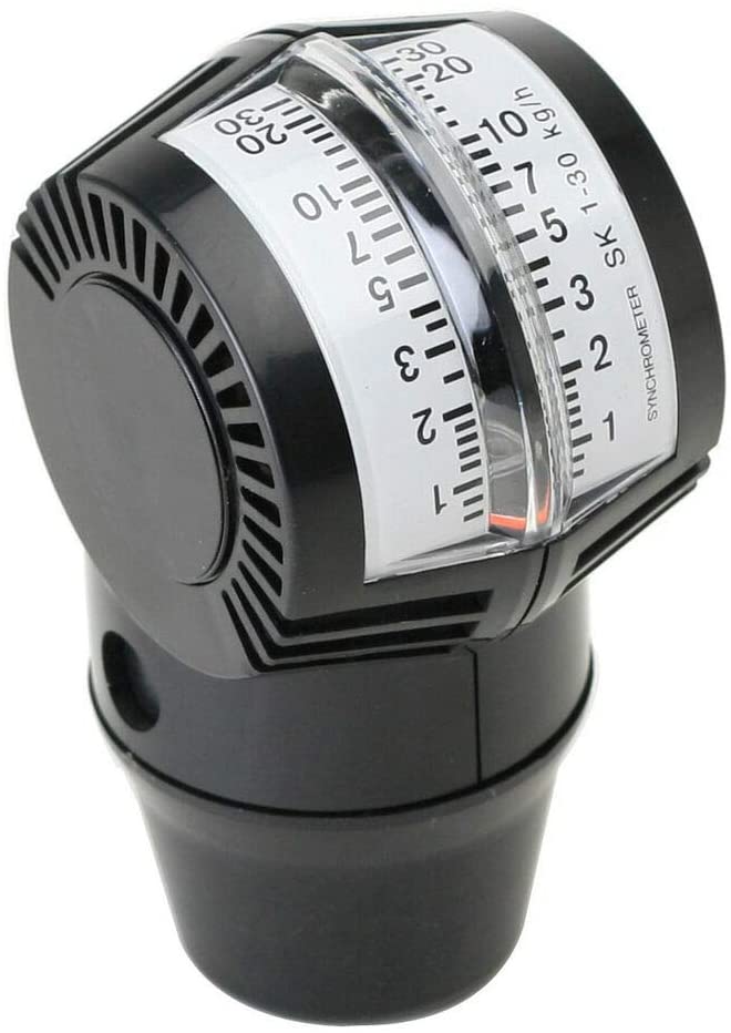

Mr. Adler mentions ColourTune and air flow devices, the ColourTune tool is a good investment, I've two so as to see both carbs at the same time. As for the AFM, the one illustrated in the PDF is now "counterfeited" and not near as accurate or reliable as the original ones.
This type has been more consistent recently, prices are all over the map tho:
