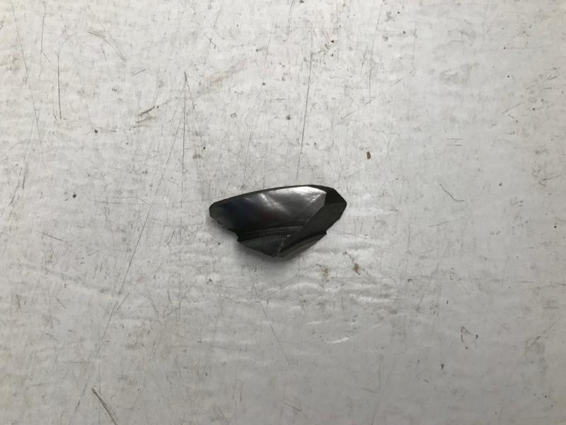

I have the axle out with the opening for the differential facing up. I go to put the differential back in for safekeeping and to drain the remaining oil into the case and I hear something drop into the case. Sounds like a washer. I pull the differential out and see this:
It was running quietly, but if this had stayed in the gear cluster, that might have changed dramatically.

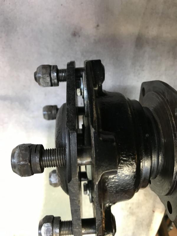

I've had to replace the left rear axle bearing a few times. After the second time, a careful look at the half shaft indicated that the flange wasn't perpendicular to the shaft. Ah, that's it! New half shaft, bearing and seal.
~2,000 mi later, leaking again. Maybe I didn't clean it well enough. Cleaned more thoroughly. New half shaft, bearing and seal. Panhard rod bracket on axle is broken. Fabricate a new one.
~3,000 mi later, have to change the brake pads (rear discs). Notice what looks like brake fluid leaking. Replace calipers with rebuilt calipers. Putting new caliper on and notice a drip of gear oil. Grrr. Mention to our local Sprite guy. He suggests that I check if end of axle case is bent. After figuring out how to do that, discover that hub and half shaft flange do not align by ~0.1". Look for sign of damage on axle case - none visible. Thus starts the current disassembly. Replacing case, hub, Panhard rod and now differential.

John - did you ever jack up the rear and observe the runout on the LR wheel and/or rotor vs the RR?
Are you driving the BJ9 to Deadwood?
This will give you an idea of the LR misalignment, about 0.1". When bolted up tight, the half shaft flange seems to override the hub:
The runout on the half shaft flange is about 0.001".
The RR flange and hub mate perfectly. In case you are wondering, the 1/4" screws and washers are to hold the hub bearing spacer ring to keep the hub from wobbling.

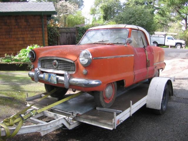

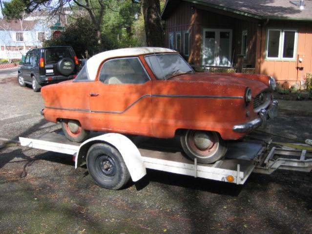

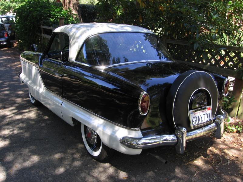

I enjoy the "barn find" and restoring it--solving what ever problems arise, and fixing them--I have restored --lets see--2 Morris Minors, 1 Mg Midget, and 3 Nash Metropolitans--
In every case after I drove them around the neighborhood, and determined they were safe and reliable--I put them on ebay--I figure I sold each one for probably $2,000 less than what I had in them,
but that wasn't the point--the point was to get "seed money" for the next project car. A couple of neighbors watching all these projects, said that I "lost money" on each one--and I said
"no-each project car took about 2 years of so --that's $1,000 bucks a year for a "hobby"--that's pretty cheap entertainment" besides, my wife says, they keep me off the streets, and out of the
bars-the pics I downloaded was really a barn find--all the others mentioned, were running cars--just needed a lot of work----
