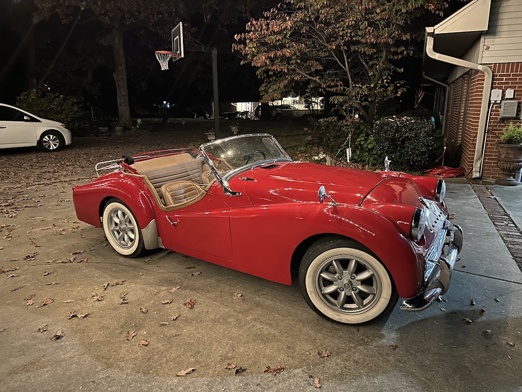

I recently purchased a 1959 TR3A. It was restore by the previous owner very nicely. It runs, drives, and stops, but I am having difficulty with the clutch. When I let the clutch pedal out it engages at a different position each time. If I pump it up it engages (disengages) when I first push the pedal, meaning the beginning of the stroke. But if I don't pump it the first part of the stroke is very light and the action is at the end of the stroke.
I have plenty of fluid in the reservoir. Does this mean I have air in the line? Or something else? This if my first post. Thank you.

Love the Signal red!!
