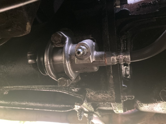

Here’s a photo of my setup thus far. If I move the hose to the hole where the bleeder is, it kinks at both ends and also pulls on it, which can’t be good.
bobhustead
The hose is where it belongs. Did you replace the flex hose or disconnect any other joints besides the master? Didyou use a tube (flare) wrench to make sure you got good tightening on the fittings into the master? I really suggest you use the hose from bleeder into a brake fluid bath as I suggested.
