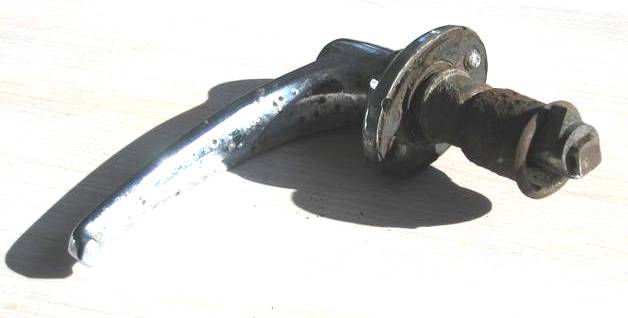

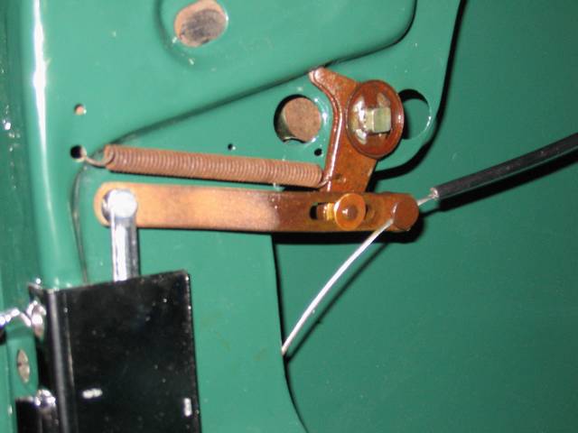

Don Elliott
In the photo above, I had to buy new door handles because the studs broke off as in the photo below. But the chromed handle outside was so pitted it needed to be replaced anyway. I'll see if I can "extract" the circular piece with the point on it for you.

MGTF1250Dave
MGTF1250Dave
Aloha Don,
Excellent photos of the parts connecting the door handle to the door latch. None of the usual TR parts suppliers show those items in their catalogs diagrams or list the bits for sale. I would greatly appreciate your help in providing that part. I'll send you an e-mail to make arrangements.
