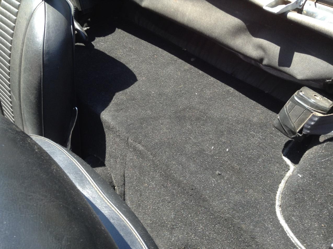

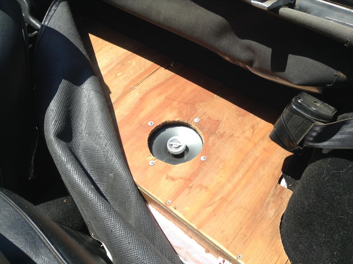

When adding speakers, most people mount rear speakers in fiberboard trunk closure pannel. I chose different approach. I installed a quarter inch thick plywood shelf directly above the flat surface behind the seats. You can mount any size speaker you want into what is now a "speaker box" (speakers need a box to push sound waves the right direction and trunk does not work well for this).

This causes rear shelf deck to be about 6" higher than stock, so when I installed carpet (Home Depot marine carpet), I had to run it higher to cover deck. Change is invisible unless you look real close. Plywood is strong enough to support anything I would put in there.
