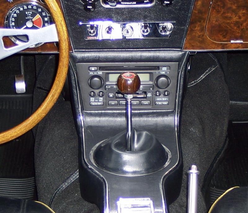

A whiie back I installed a Bose radio from an Acura to provide a multi-input sound and entertainment system in my Healey. Having collected many tapes and disks over the ears and wanting more modern inputs as well as AM/FM frequency radio, I chose the Bose system's full sound to transport me back to my early 20s whenever I drive my Healey.
To specifically answer your questions,
1. Many modern radios do not require a common telescoping antenna to receive radio signals with most incorporating a built-in electronic unit for this purpose. Although my Bose radio had a standard antenna input that I did attach to my original fender-mounted antenna, I have never needed it to receive all available AM/FM frequencies.
2. 2 power sources were required. The main operational power/sound fused power input was attached through the ignition switch and body grounded. This power would be cut when the battery ground switch is turned off. The separate second required fused continuous power source is needed to maintain operational and security memory-resident code. These independent set of power and ground lines were routed directly and connected to the appropriate battery terminal to maintain power. Since the ground wire is directly connected to the terminal, the circuit would remain completed even though the battery cut-off switch was turned to off.
Hope this helps,
Ray(64BJ8P1)

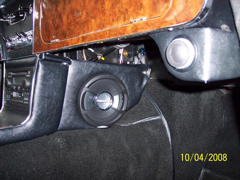

Hi Glemon,
Although I have the original radio/speaker and console on the shelf for concourse level replacement, I can definitively state that the driving sound was like listening to one side of a tin can telephone connected by a string. The radio pictured was larger then the original console to accommodate so I fabricated a replacement unit to accommodate the additional 1/2". The radio now has Bluetooth added along with CD, tape and AM/FM so I have great choice. I find I use the period tapes most and is the only player I have that can accommodate them. The one issue I had was where to install the Woofer and its amp. Since there is a definite shortage in space, I ultimately chose to install the woofer in the center of my spare tire with its amp placed under the battery.
Although my installation is quite extensive and does provide volume and good sound, today's sound technology is so much better and condensed to the point of being able to hide an LCD screened/receiver placed behind an original speaker grill that has been modified to pop-up for use. Controls cab be either voice or screen input and an additional period radio dial and knobs could be added as a dummy to further the concourse look.
Speakers can be incorporated as I have or hidden under the dash that can provide good sound with a woofer, flat enough to be installed under the driver seat to really get you to feel the beat. No standard antenna is required for radio reception but, as AJ has requested, some method for providing continuous power is necessary to maintain internal code. If I were to implement a new sound system, this would be what I would try for.

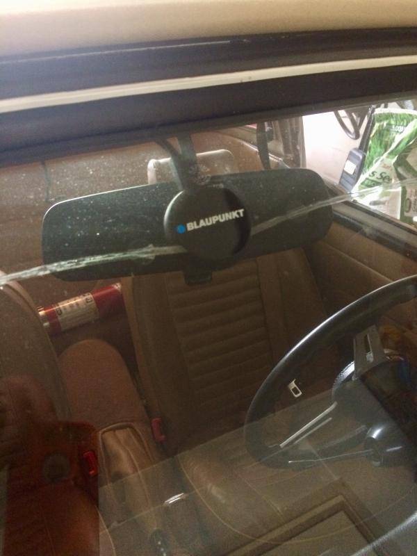

After I completed the restoration of my car I too could not bring myself to drill a hole in the wing for an antenna. Instead I decided to go with a Blaupunkt antenna amplifier which is connected to the original Triumph AM/FM stereo radio.
There is a thin wire that extends on either side of the Blaupunkt antenna amplifier. The wire is held in place with some clear tape and is hardly noticeable.
