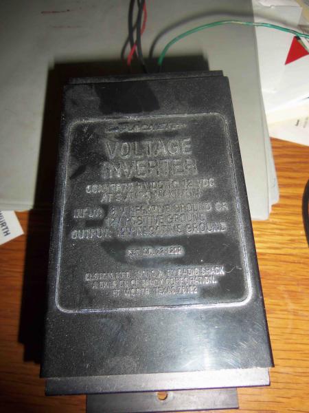

Your other possibility is to use a voltage inverter. I used this Archer unit for 20 years in my positive ground TR3 to run the radio. I took it out years ago as I "was" going to go to a alternator system but changed my mind. I had already purchased the Pertronix for the distributer for negative ground thinking I was going to convert. So I did have to go to negative ground to use the Petronix. Now that I'm about done with the 2nd restoration I'll just hook up the radio as normal and was planning to list this on EBay.
