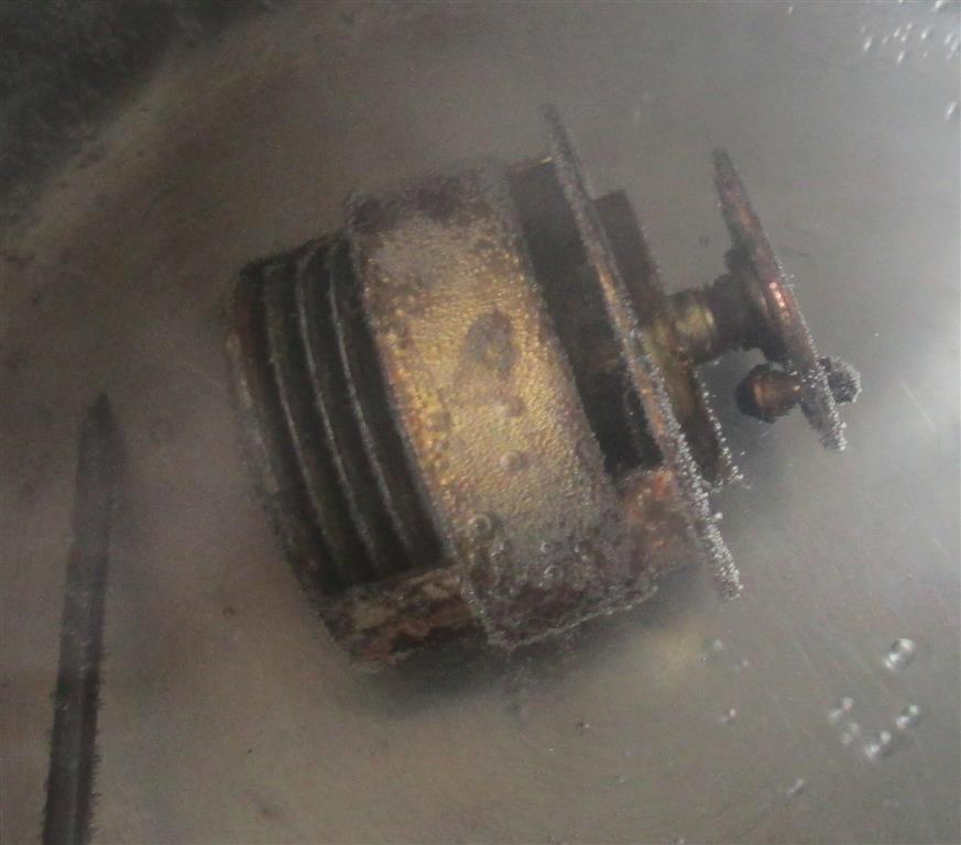

Was having some cooling issues with my TR3. Just removed the thermostat this morning to check it out. It is part 2236 and is marked as 72 C (which is about 162 or so F, so summer setting). According to my digital thermometer (accuracy unknown) it seems to start opening just before 140 F and appears to be open as far as it goes by about 175). Quick question, is it fully open in this picture? Do these temperatures for opening seem about right? Thanks, Mike

that bellows certainly seems to be working properly - when they fail the bellows cracks and they won't open at all.
