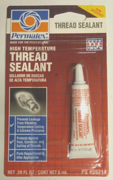

The gearbox plug is tapered pipe thread--possibly the same as the two on the differential--and doesn't use a washer/gasket. I use teflon thread sealant on these and it seems to help prevent leaking. The OD has a fiber gasket.

I had a small leak from the transmission drain plug that I stopped with some thread sealant. I had never heard or seen of thread sealant before but read about it on the forum. I always used Teflon tape before which usually worked but I like the tread sealant in a tube better. I purchased it a NAPA.

steveg
attachment.php
Seals metal threads (no rubber or plastic) in oil, brake and fuel systems.
