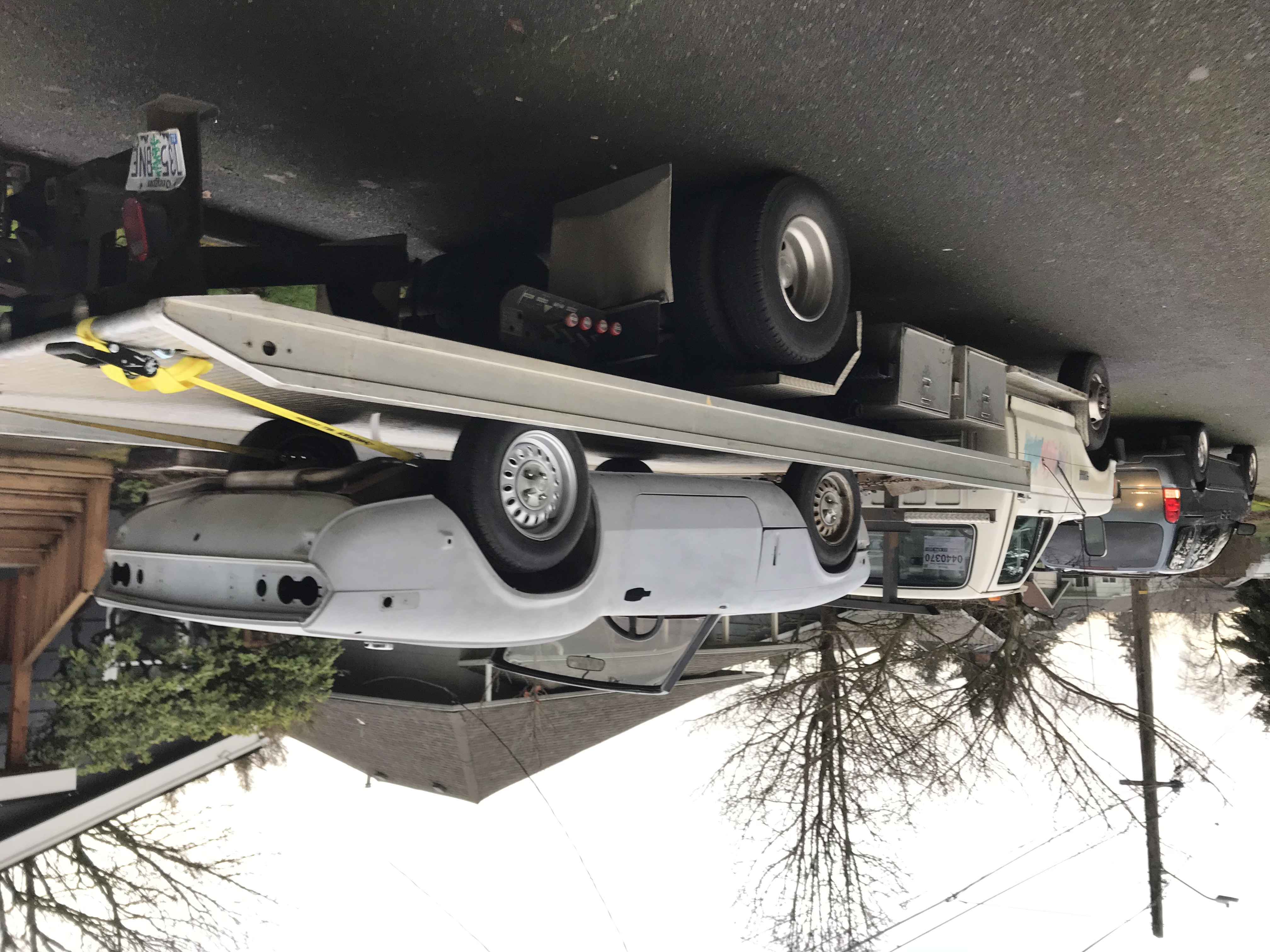

Eventually I'm going to get my 1980 Spitfire back from the painters, and then it will be time to put it all back together (just in time for Spring!). I'm going to need to insulate it -- for sure against heat, and possibly for sound. Any recommendations?
