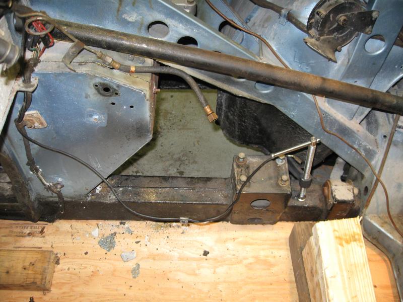

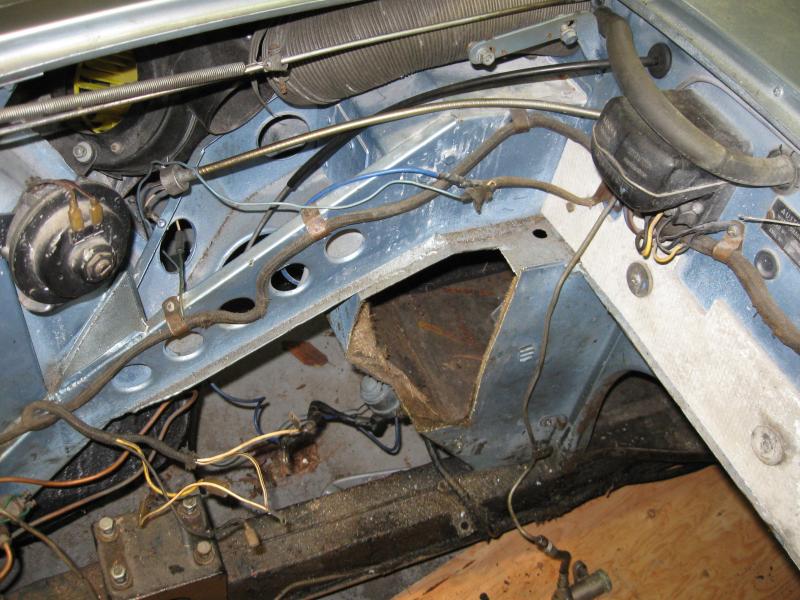

Here's a picture of the side of the toe box on the driver's side showing the spacers on my BJ7
I don't see an outline for the standoffs on the passenger side nor does it look like they are on the firewall, either:
It's possible they only used them on the driver's side because that's where the exhaust pipe runs. I still have the original asbestos pieces so I can check them to see, but won't be able to get to them until next month. I'll check back with you then if you're interested.

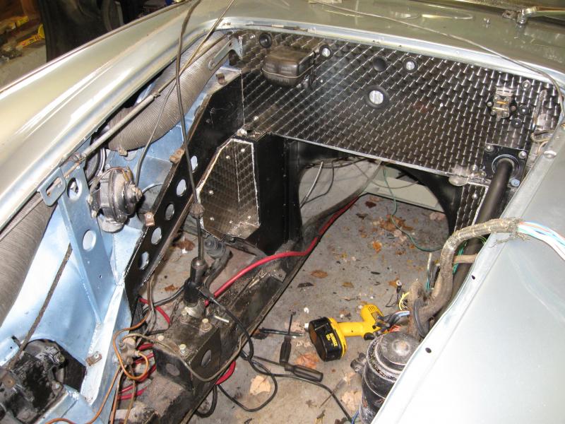

Because originality wasn't my prime motivation :devilgrin: but keeping the heat of the V8 out of the cockpit was, I addressed the issue with engine-turned stainless steel covers over a layer of foil bubble insulation (Reflectix).

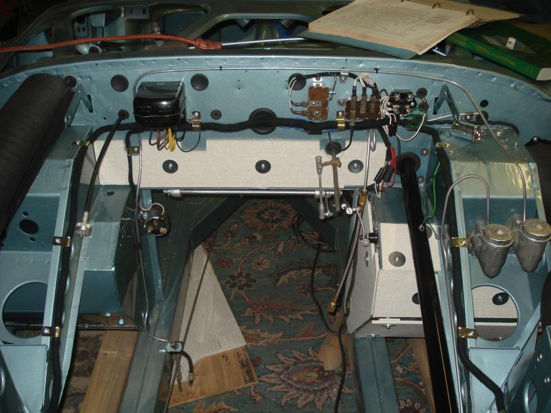

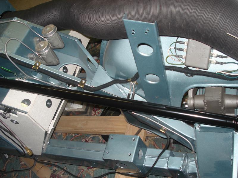

The firewall one has no spacers. It sits flat on the firewall. The upper two on the footbox also sit flat with no spacers. The one on the side of the footbox, and the ones on the immediate front and bottom of the footbox all have spacers. The one on the floor above the muffler also has spacers. In my picture you can see the spacers on the muffler shield as it is lying on the floor waiting installation.
