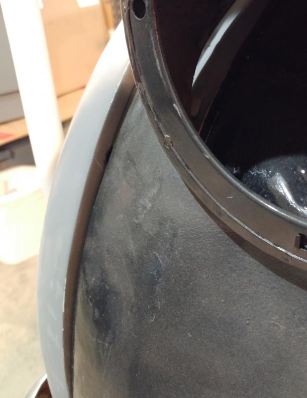

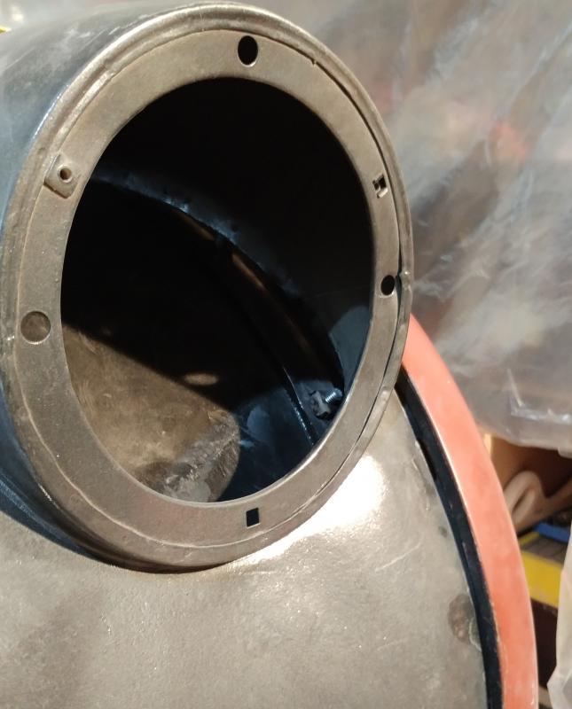

Thanks for the input from everyone. I am posting a couple of photos that show the misalignment issue. This car is a collection of parts. One fender has round holes for the bolts that attach to the front apron and the other fender has oval holes. Both fenders are in great shape...that's why I'm using them. I expect that the one with the round holes is an aftermarket. I see what you mean about loose fitting all the components first. Before I was working on this end, I replaced the rear apron. I must have put that thing on and taken it off at least 50 times before it was positioned right so that I could get it welded in place. So what do we call this...a labor of love? I am thinking that the front apron has lost its normal curve, likely from moving and shipping and storage. I'm not real excited about try to re-establish the normal curve, but I want it to fit right and line up with the fenders as it should. The top and bottom of the apron seem to be flush with the outside edge of the fenders.
After looking at the photos, let me know if you guys have any thoughts.

I would not bolt the apron to the tub just yet. Let the apron float on the tub between the fenders and bolt those 3 together; the round holes usually means a early fender. You might even want to remove the bridge or tie piece on the apron, so can the best fit. You my ever my want to remove the tie piece brackets that are welded to the tub and re-weld them, but not yet. Like others have said, the hood and the doors are critical also, especially the doors, they open and close. I really do not see that alignment issue in the pictures as a problem that cannot be fixed by fiddling . I can see a bolt holding the apron down through the headlight hole. How does the hood fit now? I remember John posting how a tr2 hood has a sharp edge at the back that I think he even trimmed.

I can make my fenders look that far off . To me once you get to the point you are , I would loosen or back off (way back) the bolts between the fenders and the inner fenders. Then I would concentrate on trying to get the fender to apron bolts in and see if you can get the fender and apron to match up. Then you can go back to the fender to inner fender bolts. Right now the inner fender is holding the outer fender in place and not allowing you to manipulate the fender to apron.
i say this as I see the bolt through the left headlight hole holding the inner and outer fender together. I could be wrong on this but hope it helps.

I said that wrong; what I meant was, I would not bolt the fenders to the tub in the front yet. Let the whole front end move on the tub. I would put the bolts in the back of the fender starting at the top to push the fenders forward then bolt the fenders and apron together . I use drift pins or small sleever bars/ tapered shafts-- to pry the fenders left and right through the bolt holes and up or down after the 3 are bolted together. I believe the apron will come up to meet the fender by prying or pushing and pulling. I would put a drift pin through the head-light hole from the apron to the fender and pry down and work the high spot out, but I would try and work it out as I went.

Looking at those pics...that's actually a great start! Start at one end (top or bottom..and I personally recommend bottom to get the ends even)..and work one bolt at a time to the other end. Pull and push the two into place as you work one bolt at a time. If a bolt absolutely won't pull the parts into alignment, snip the outside of the bolt hole in the wing to allow more change in curvature.
