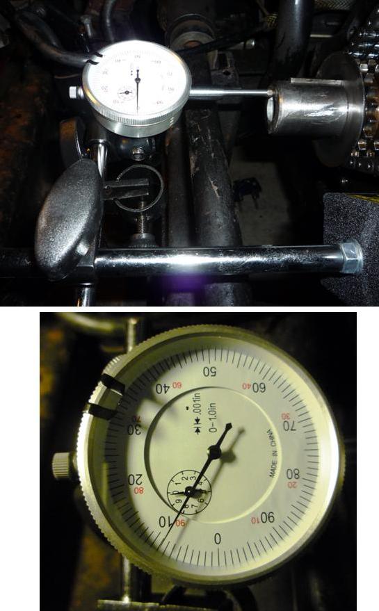

I am in the process of replacing the front oil sleeve and oil seal. While the timing cover is off, I decided to check the end float.
It measures about .009 (.0085 to .009) of travel.
Is this something I should be concerned about?
If I have to correct it, is it a big undertaking?
The car by the way is a '73 TR6. Thanks for your input!

I have a 73 TR6 also.
When I changed out all the bearings I also replaced the thrust bearings that control the end float.
ISTR that the float is supposed to be about 4 thou, putting new bearings in brought it back to that exactly.
In my opinion for 9 thou it's not worth tearing apart to change them; if you're in there doing something anyway then you would change them.
If you do decide to change them make sure you put the new ones in the right way round.
Changing them is simple enough, drain everything, drop the sump, unbolt the rear main bearing cap to access.

Agree completely. The loads on the thrust bearings are minuscule compared to the loads on other bearings, mains, rods, and cam. They should be the last things to go. Unless you know that the above-spec end float was caused by a poor rebuild in the past, too much end float would probably indicate that more bearing work will be needed. It is unlikely that dropping the pan to fix just end float would make much sense.
