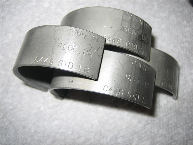

tomshobby
Did you check your bearings? When I did my TR6 engine these were in the set I first got. They were from a reputable vendor and mfg. But things can happen.
What kind of tool did you use to measure your crank? For example, a caliper, digital or dial, is not a very reliable tool and should not be trusted for anything closer than +/-.005". And like Rut said, your technique can vary from the shop's and even between uses.
I completely agree with the use of Plastigage for a final check. My engine builder used it and they gave a written 1 year 12,000 mile guarantee. That engine is far past that now by several times and still running great.

I used a good micrometer to measure but I guess I'll recheck. The angle can be tough while avoiding scratches to the crank so it's possible I got off a bit. I'll use plastigauge.
