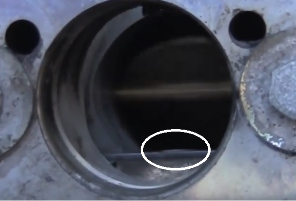

Ok, I'm at a loss. I've been fighting with my TR3 running very rich for several years with black smoke spewing from the tailpipe. After my Buddy made fun of me this weekend I've decided to do something about it. I had my carbs rebuilt by a carb shop several years ago but they leaked so I took them apart and did them myself. My problem was that I could screw them all the way lean and it didn't seem to matter. I thought I figured it out last night when I noticed the jet never came up even with the bridge so I took pulled one of the carbs today to see if I did something wrong because the top of the jet as always slightly below the bridge. If I remove the top copper washer, the jet comes even with the bridge....but that obviously isn't right. I've looked at hours of video on YouTube and from the attached picture, I see the top of this guys jet is even with the bridge. Am I doing something wrong?

It should be pretty close. The choke also affects the level of the jet. Have you looked over the choke assembly to make sure it is not binding, sticking, mis adjusted or bent so as to hold the jet down?

Bill-Many years ago, I fought the same battle-couldn't get the jet to the top of the bridge and mixture lean enough. A couple of things to check-make sure the jet is against the adjusting nut. Make sure the cork seal (Moss #97)is fully compressed. Also, make sure there isn't another copper washer lurking in the carb body.
In the end, I machined about .020" from the shoulder of the upper jet bearing, which allowed the jet to reach the top of the bridge. In thinking the problem over, it probably wasn't necessary. I achieved the proper mixture with the jet about .040" (its been a long time ago) below the bridge. So if you use a dial caliper to set the starting jet depth, it shouldn't make any difference.
I guess I should have asked how far the jets are from the bridge with adj. nuts full up and if it is equal on both carbs.
