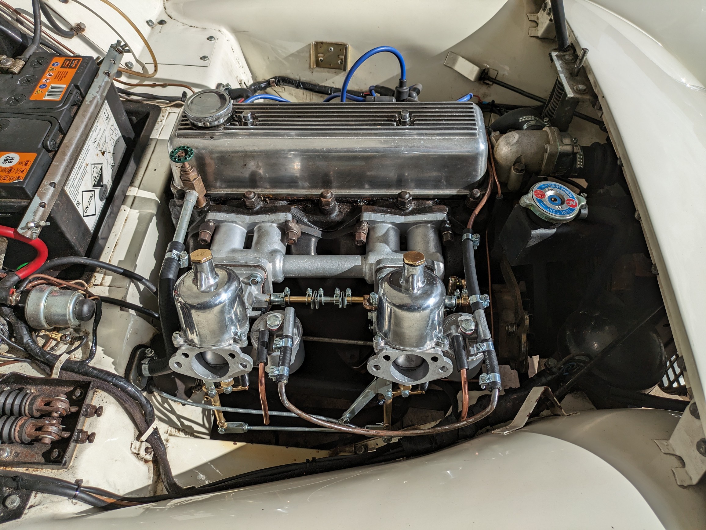

I have a TR2 with a high port engine and SU H6 carbs which have just been refurbed.
Having started and driven well, my friend and I were trying to balance them. All was going well until the car spluttered to a stall and then wouldn't restart. It nearly catches but splutters to a stall. I have even had a backfire!
Power and spark is good, fuel supply is good. We are at a loss, so any advice gratefully received.

I would start with a visual of the butterflies opening and closing fully in sync,and check that pistons are free and pass the drop test with a click test.
Then check fuel level by observing height in jet,which should be slightly below jet top.

Gross jets are not working,Check the float levels.What is the fuel pressure(electric?)
When the float levels are good , remove the piston/pot assy and look down at the
jet bridge. the fuel level is visible and should be 2mm less than topping over. Both
the same naturally. re-install the pot assy and fire it up.

If you have flooding, then check that fuel pressure is not above 3 psi, and then look inside the carb throats and ensure the fuel level is not running down the intake into the engine. Set the floats as Mad Dog suggests.
