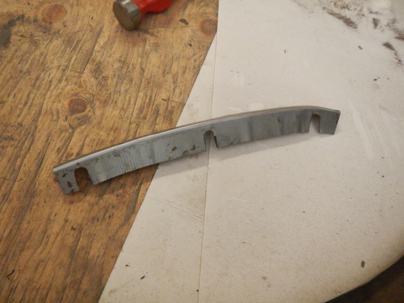

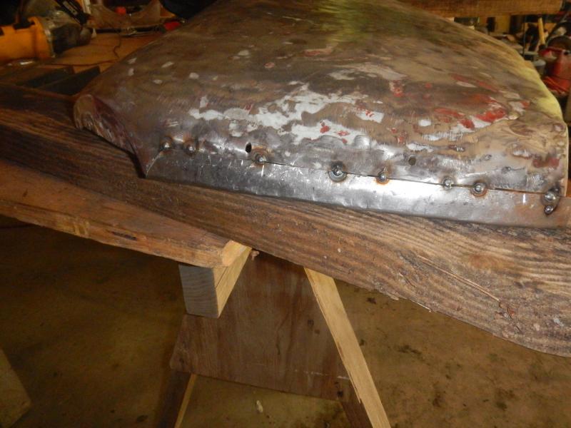

I had similar problems with the Passenger side rear wing. Ended up making a flange so I had something to bolt it on with. Got a Harbor freight shrinker and stretcher to get the curve.
Worked out well all around. The rest of the wing required a lot of beating and some bondo.
David

An excuse to buy more tools. I like where this is going.
Nice job. I will take a shot at the repair I really have nothing to lose.
David
CJD
That does sound neat. I bet it's much easier than cranking the torch up too. David, you did it...I want another tool too...
DavidApp
For a Harbor Freight tool it works well. I tried the cut and weld trick but it did not work out that well so I got the new tool. Did a great job on the front wing flange as well.
David
