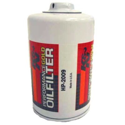

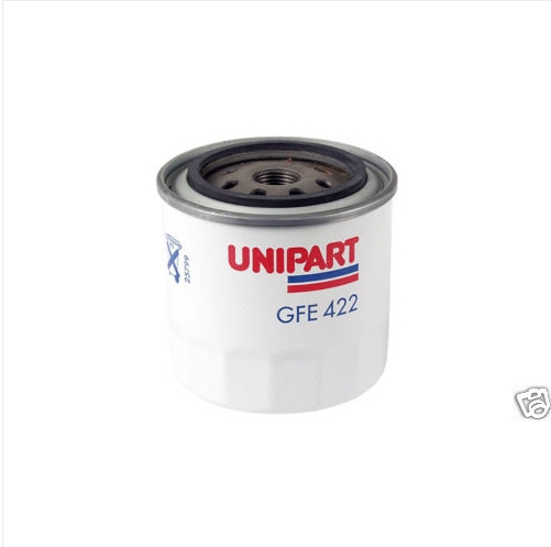

Does anyone have a part code for the filter used in the new spin on oil filters. The one supplied in the kit does not have a number.
i got what I thought was a suitable replacement at the auto shop however when the car was started, no oil pressure. Have traced it to oil entering the filter, first point on from the pump but not seems to be exiting the new filter, seems strange, any thoughts?
thanks in advance

K&N 2009 filter 414D3FQDGML._SS400_.jpgSPINFILTEROIL12.jpgFind this on SPIN Filter Kit instructions
Check installation by inserting a pencil in center and bottom oil holes in adapter. If
pencil goes into block, the holes are in correct alignment. If not, you have not installed
adapter correctly and your engine will not get oil. Reinstall and check hole alignment. Replace
drain plug in pan and follow manufactures instructions on spin on filter. Put in required
amount of oil and start engine. Check for leaks! Check for leaks check for leaks!
Filter to use. Wix 1516 ,NAPA Gold or replacement. Not all replacements have
the anti-drain back valve. ( To check for this valve look at the filter's small
holes, you should see a black baffle behind these hole to prevent the oil from draining out of
filter when engine is not running.
Important: check starter cable terminal so it does not short out
The Wix filter I use on both my Healeys is their number 51516 (equivalent to the Fram PH3600 I bought with the first one from Moss). A while back I bought a dozen on eBay for about $5/per; they're still available from several suppliers:

I had a similar experience a few months back--after draining oil and changing the K&N spin-on filter I restarted and OP did not come up after at least 30 seconds of running. Several posters on the newsgroup suggested that I simply back the filter off so that the gasket was not in contact with the adaptor base so as to allow air to escape. I followed the advise and let the engine run at idle--after a few seconds oil dribbled out around the base of the filter, the gauge came up and my 10 psi OP light went out. The experience was a bit disconcerting as I have never had to do that before but in any case no damage done.
